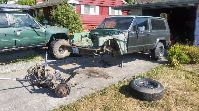

Today we got the jeep to the house and and pulled the motor. We pulled the motor for my buddy who paid the other half of the $200. He will be rebuilding it and putting it in his jeep. We also got the interior out. I will be getting the front end off this week and removing the front of the frame. Here a few pictures from today and i will post pictures as i go. I just hope this thing goes like i have it in my head.

So i got the front alxe/suspension out today. Went alot quicker then i was thinking. Going to save the front shocks and move them to the rear and have 4 shocks. The shocks only have about 200 miles before the jeep stopped running. More to come in a few days.

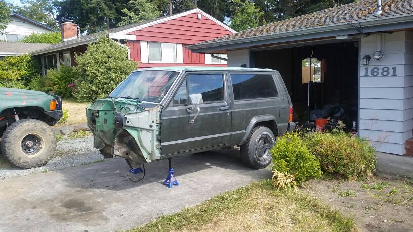

Woke up earlier then i wanted to so i had some time to kill. I Cut the front end off just forward of the firewall. The firewall will eventually get removed just not yet. Dont want to open it up to the weather or animals. Next i will be opening up the unibody to figure out what size tubing will slide in. Then off to skagit steel next thursday.

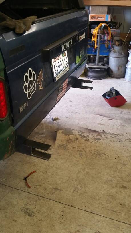

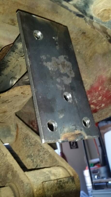

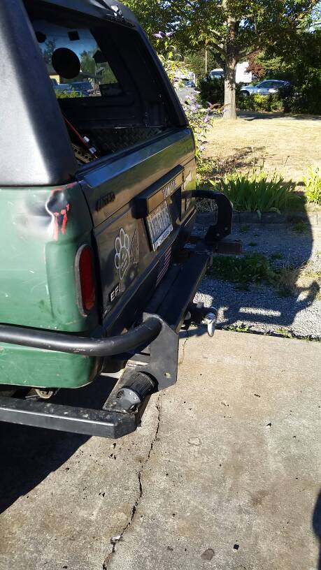

I hate when posts end not knowing what happend or being left to wonder. No new progess on the trailer besides a name. I shall call it the Jeeper. But i did however get the opportunity to use my buddies shop. So i took advantage and started my rear tire carrier. Going to walker valley in a few days before i take off for work so i needed my bumper back on. I had to take it off to make all the measurements. Here is the progress. I will be ordering all the metal whenni get back and start back up.
