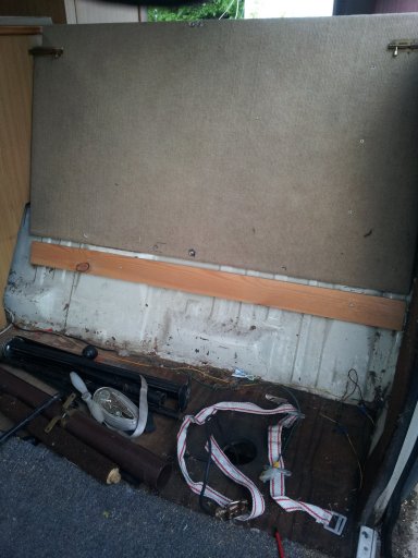

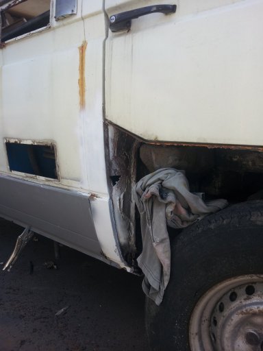

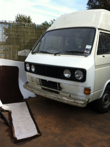

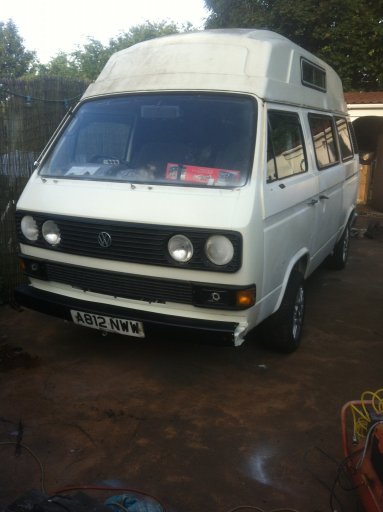

To be honest, in 2014 when I bought this van it didn't start out as anything like overland capable.
This was supposed to be a little campervan to get myself and the wife away occasionally.
I had been looking for one of these vans for about a year when I found this one.

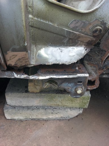

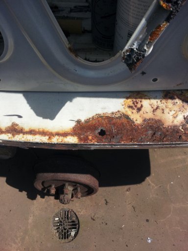

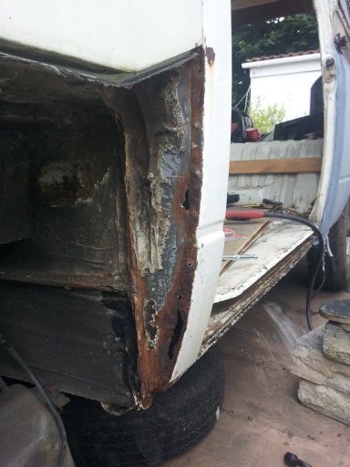

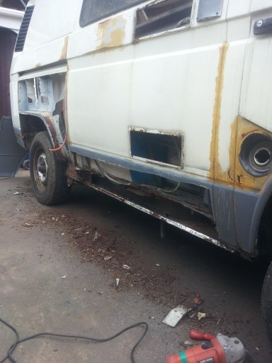

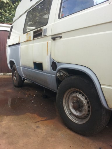

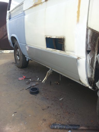

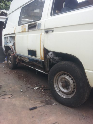

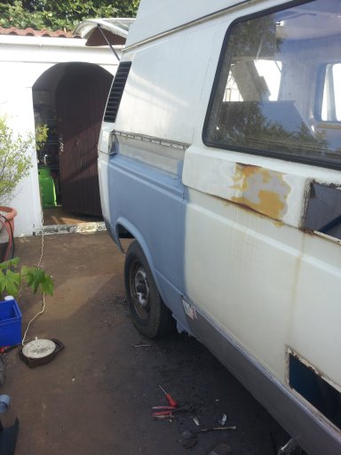

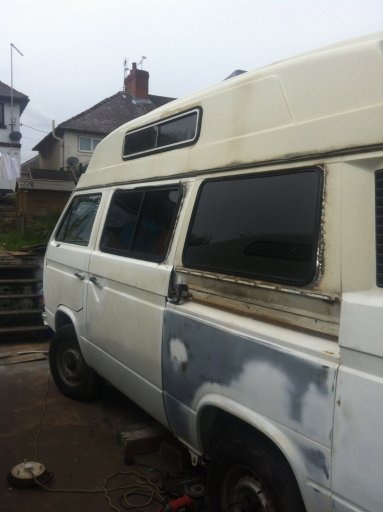

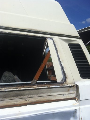

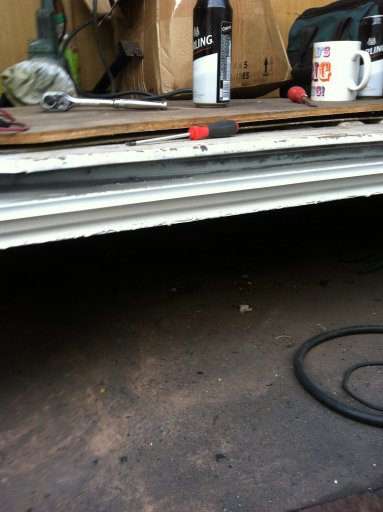

Completely rotten from the door handles down, interior smelled like your grannies outside dunny, complete strip out and start again.
I bought an angle grinder and a mig welder within an hour of driving the van home. The gods of vanners must have been with me that day for the vehicle to actually make it the entire 12 miles home before all manner of things collapsed.

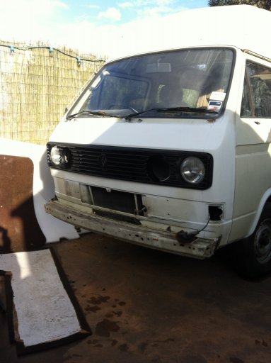

This lot was removed due to the rot. I think I should have scrapped it at this point.
After a lot of thought ...I had ordered the new body panels, sills, chassis cross members and a shit load of other wallet emptying parts.
So I continued on the left ( as viewed from the rear) hand side.

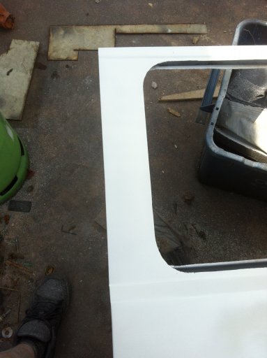

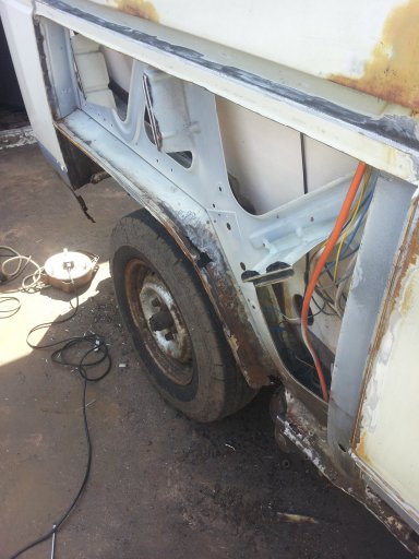

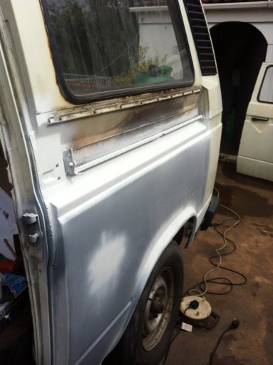

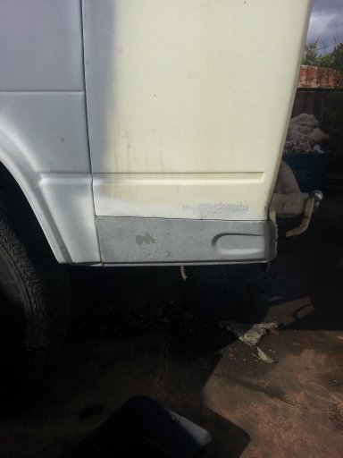

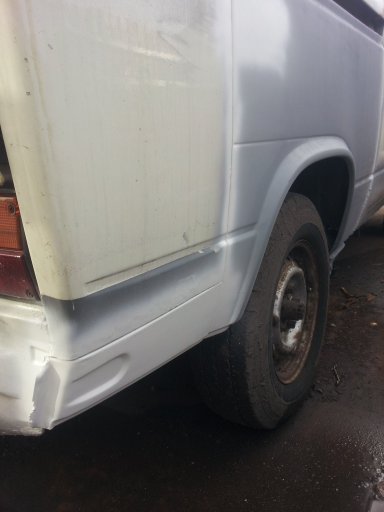

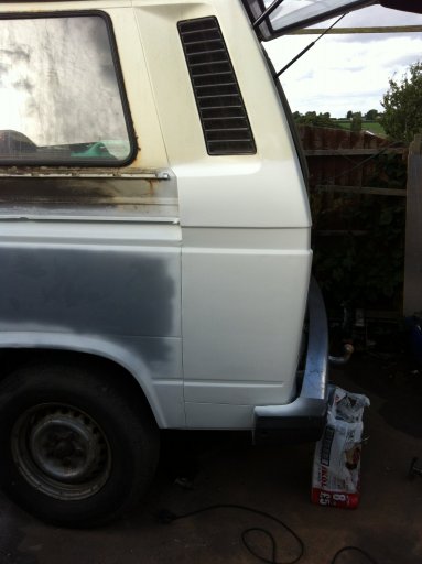

Then after the rot removal and fabricating the missing parts, time to weld in the new panels.

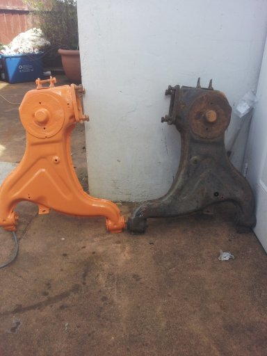

Got myself a pair of good trailing arms too, in 2014 when I was building the van, these were not available from the usual sources. JP Group have since started making them and are available world wide.

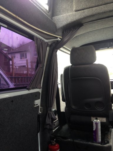

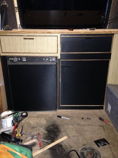

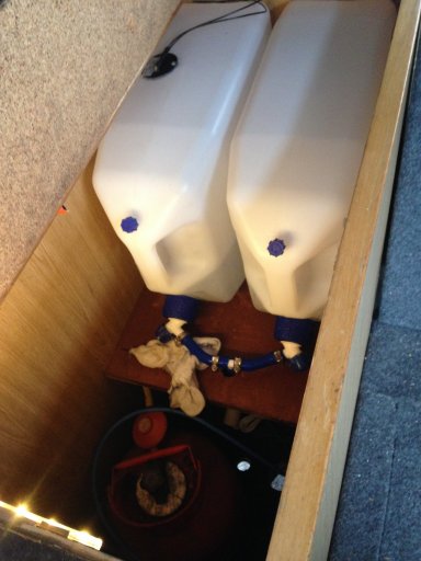

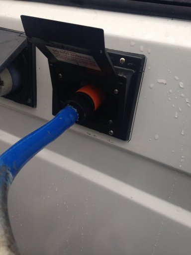

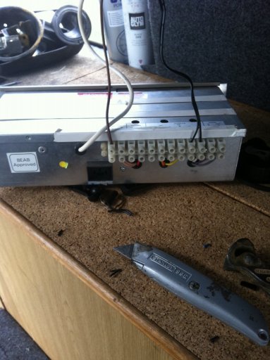

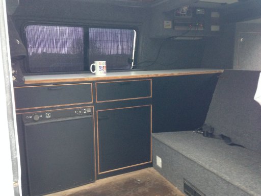

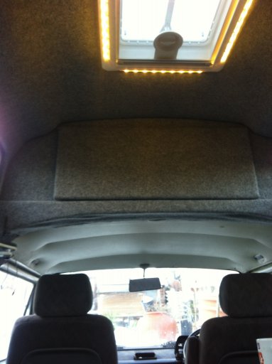

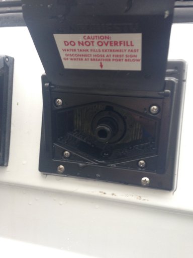

December 2014 was a busy month.
The previous 14 owners had all added their own bit of electrical circuitry to the van, out it came and a complete rewire with heftier cable.

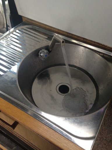

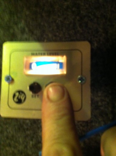

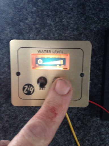

Installed a water gauge for the new tank

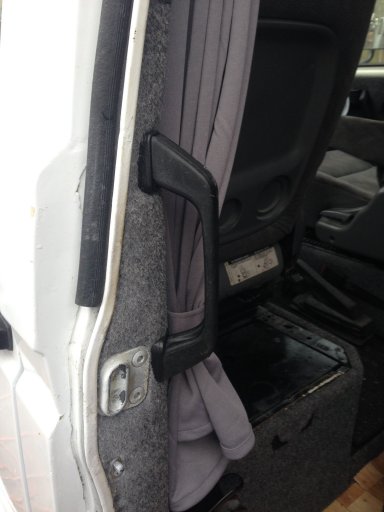

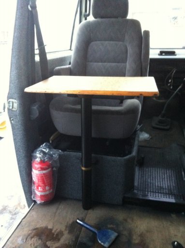

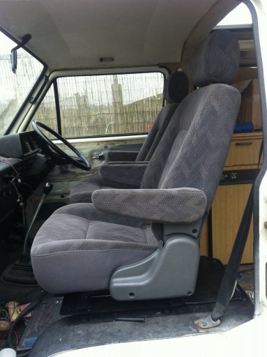

installed a swivel for the passenger seat

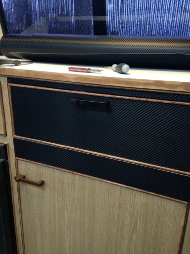

made a table for the passenger seat

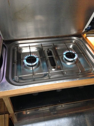

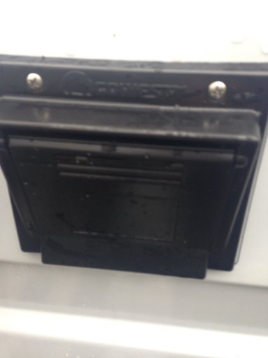

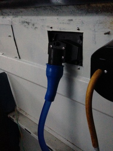

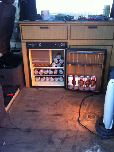

wired the fridge for mains power and 12 volt, checked the propane connections for that too.
2 of the chickens decided to join me in the van for a bit of warmth :-)

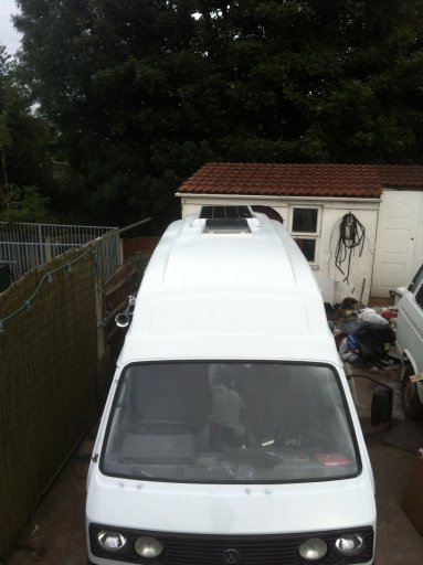

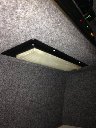

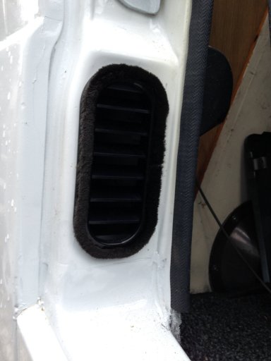

Installed the LED roof lights around the vent.

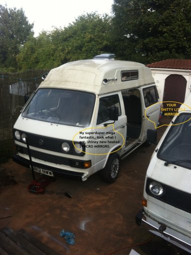

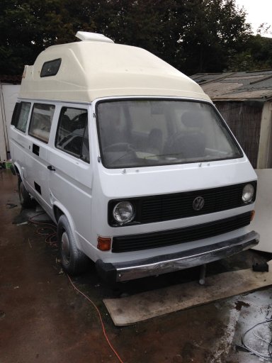

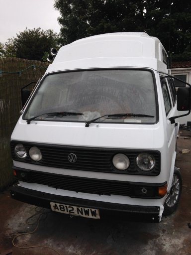

Which brings us to Spring 2015.
This is what happens when you find a set of blacked out, series 1 landrover windows at a bargain price.

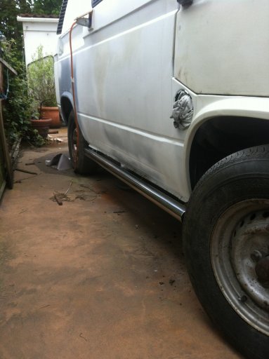

.....and a pair of stainless steel side impact bars.

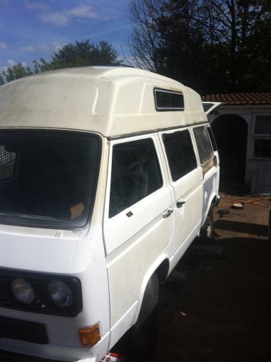

July was a slow month due to working hours.

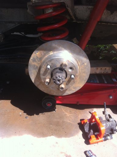

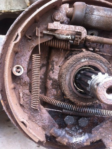

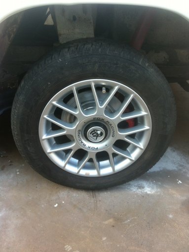

Rear brakes were shot, everything was either rotten, corroded solid or worn out.
soooo...... rear disc brake conversion time.
Better brakes, easier to maintain, less parts involved.
The original 14" steel wheels looked a bit tired and rusty,
then came some shiney 15" alloy fox racing wheels which I thought was a good idea at the time.
These have since been replaced with 16" steel Mefro wheels.

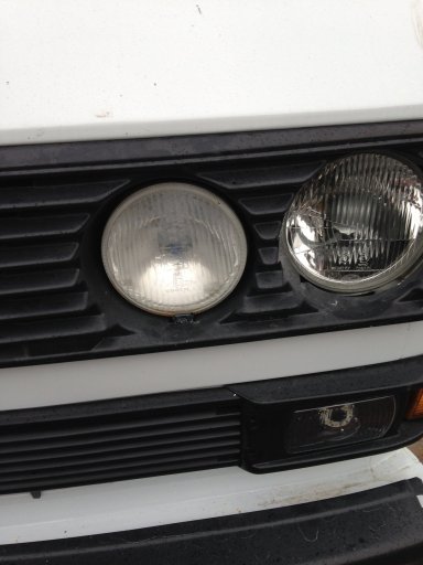

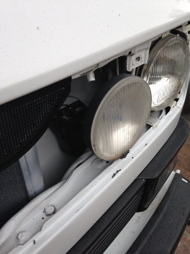

And the Terrawagen DRL
and the Taifun grilles

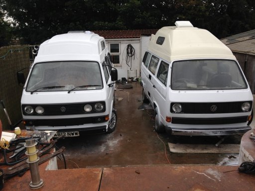

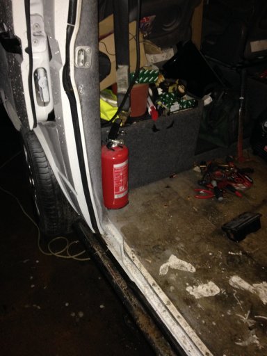

October:
Painted both vans and started putting all the fixtures and fittings back on.

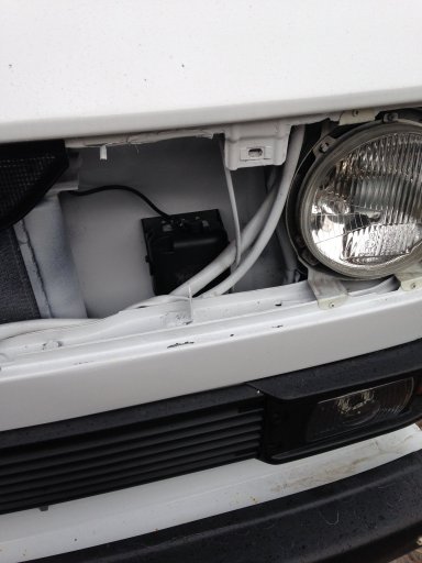

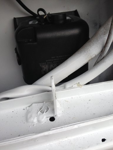

Added a Hawk alarm system to mine
If you wanna disarm it, you need to dismantle the front of the van. It has it's own backup battery :-)

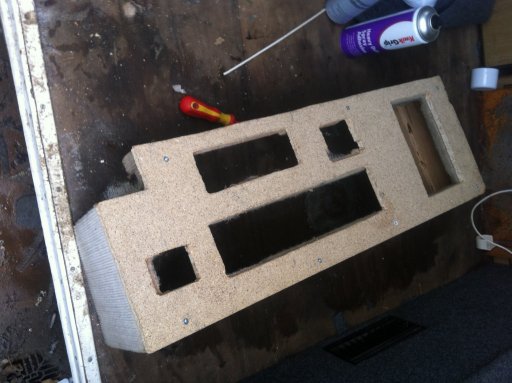

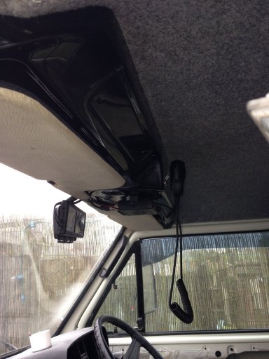

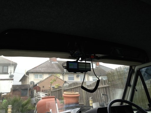

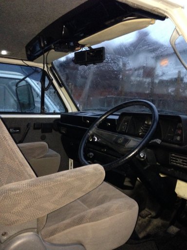

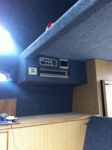

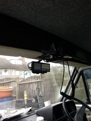

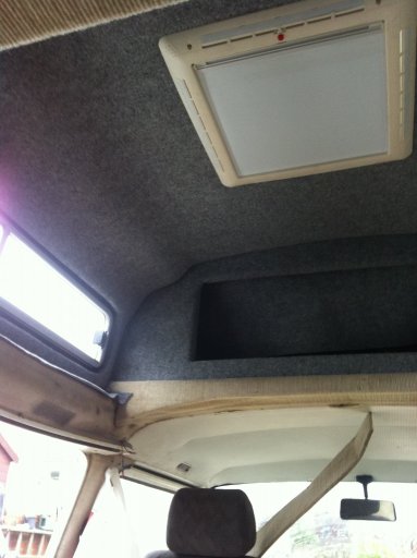

Fit the overhead console I bought from Germany, fit the CB radio and that rear view mirror ...more about that later.

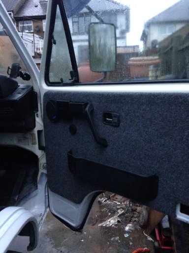

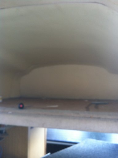

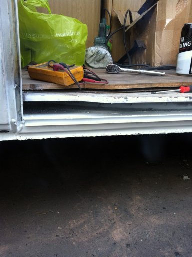

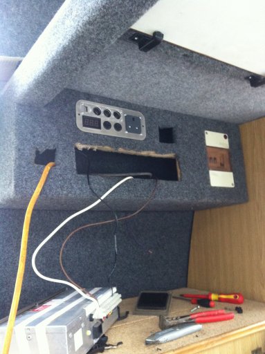

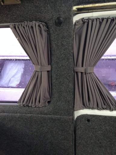

Oooooo!, my daughters made me a new headliner from the same material as the rest of the vans lining. it's fabulous.

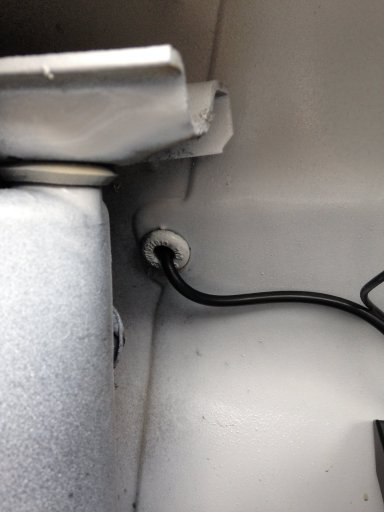

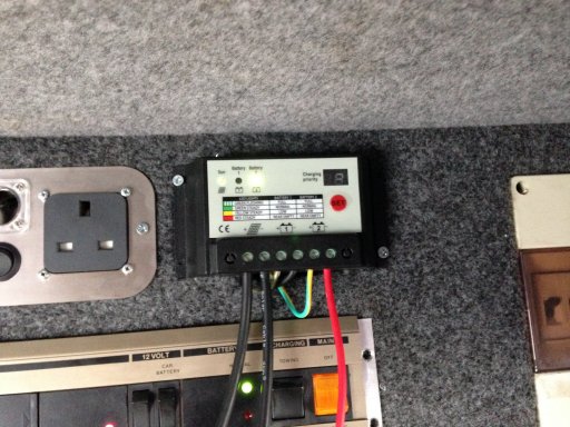

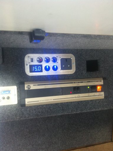

fit the solar controller and a test wire to the battery
