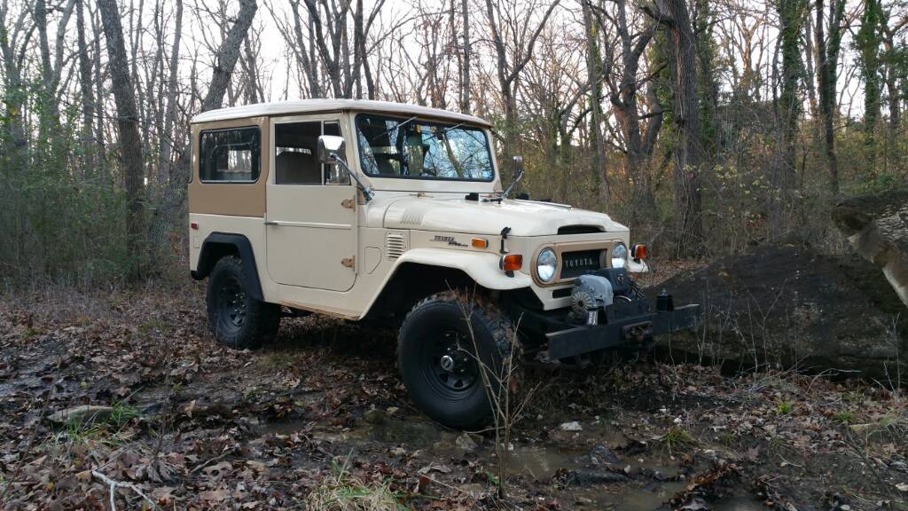

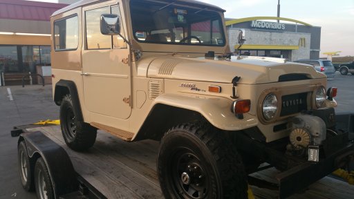

Things have changed a bit over here at Okie Built. We went from building a Wagoneer to our current project. When the opportunity came up for us to pick up a very clean FJ40 we jumped all over it! The FJ, for the most part, is stock. The motor has been swapped out for a Chevy 283 and was mated to the stock tranny and tcase with advanced adapters help.
The plan is to build a simple yet functional truck to take out on the trails. The suspension, and brakes are first on the list. Then we will move on to the "bolt on" goodies.
Really looking forward to where this FJ is going to take us.

Holy smokes this looks showroom quality, I'd keep that as my Sunday driver and pick another one to beat on trails hahaha

The truck has been rebuilt a few years ago. However the salt water air has not been too kind to it. There a several spots that need addressing to stop the rust. Its a great "tener". Looks good at ten er so feet back :)
