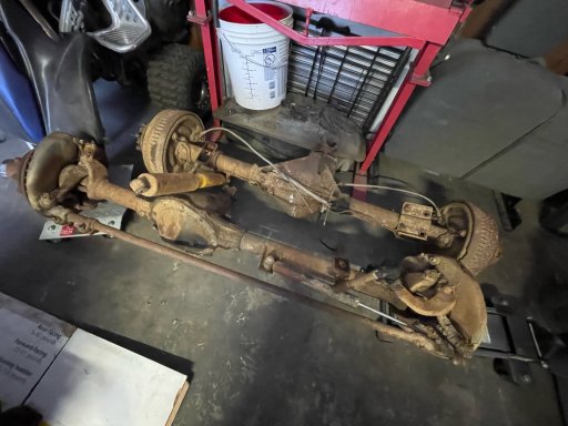

Picked up these flat top D44/10 bolt knuckles in Michigan. They are brand new for a pretty good price of $250.
I also swung by a place in South Dakota that had a bunch of old square bodies and picked up a couple NP205’s and a 203 that may get used as a doubler.

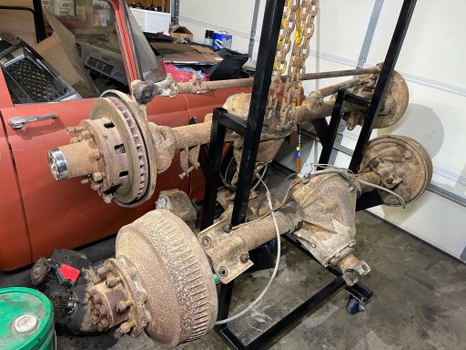

Today I got some help from a buddy. I picked up a 2 ton engine hoist from the local “Chinesium tool peddler”. We got that assembled and put it to work getting the replacement axles up on the diy rack.
