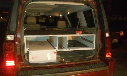

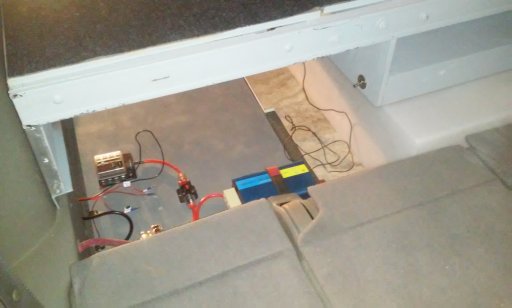

Thought I had already posted updates about the cargo space. Maybe not ... Just finished installing 21 gal. fresh water tank. If you are building on a XK, I don't recommend installing a 21 gal. water tank. Unless you don't mind doing a lot of cutting and mod work to the Jeep. It CAN be done. But it's a tight fit. Mine is sitting where the 3rd row seat would normally be. In that space is the pure sine wave power inverter, power distribution / fuse block, water pump and related plumbing for water tank. Also added another work surface / table. A 2 1/2" OME suspension lift is next.
