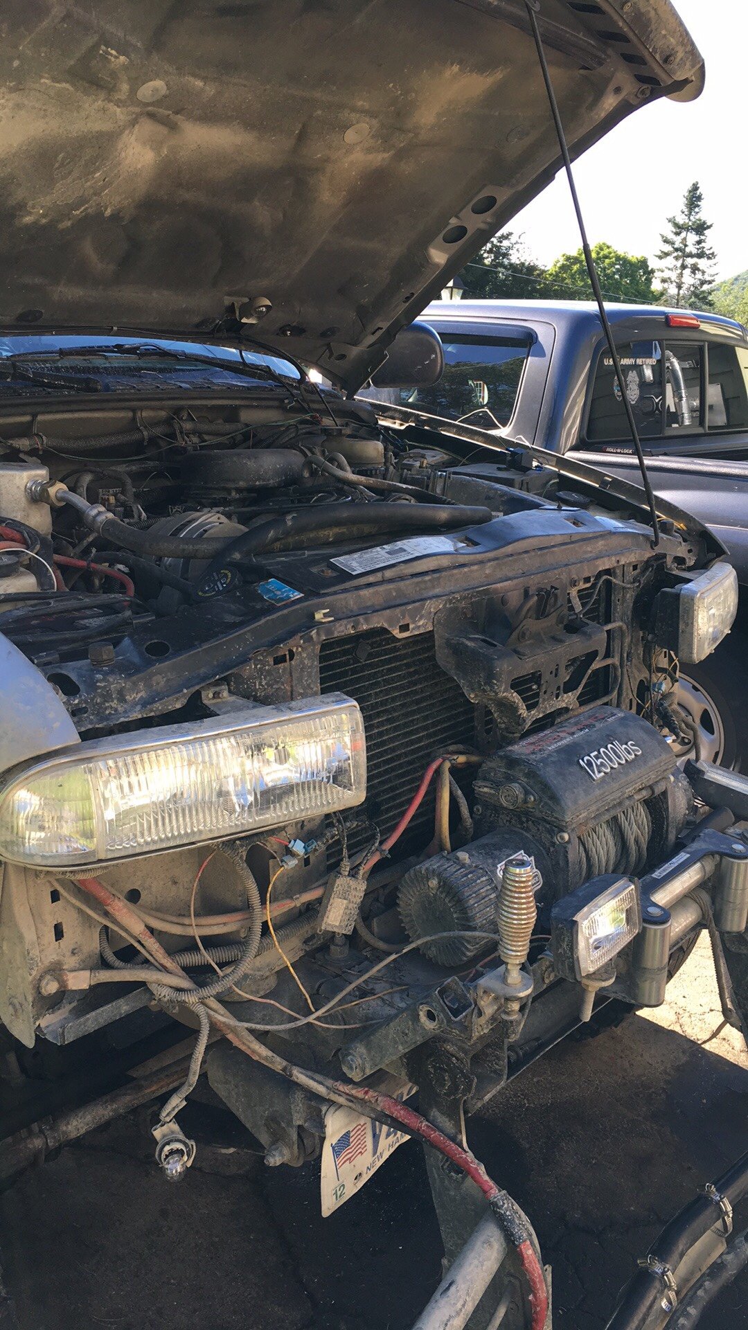

Hey everyone. Thought I'd give some specs on my pile of junk. It's an 02 ZR2 Blazer. The front axle is from a 79 f250, full width with 4.56 gears and electric locker. Reid Racing knuckles with 79 Bronco outers. WFO high steer. Astro van steering box so the pitman sticks out the front. AllPro 6" front springs. Atlas II 3.8 low range t-case. Stock ZR2 rear 8.625 ten bolt housing. Yukon 4.56's and axles. Detroit Locker. Tatton driveshafts. 200 amp alternator. Cheap eBay led's. 12,500 lb winch. And other junk. Loving the class 6 roads of New Hampshire. Tread Lightly. http://forums.exploringnh.com/forum.php

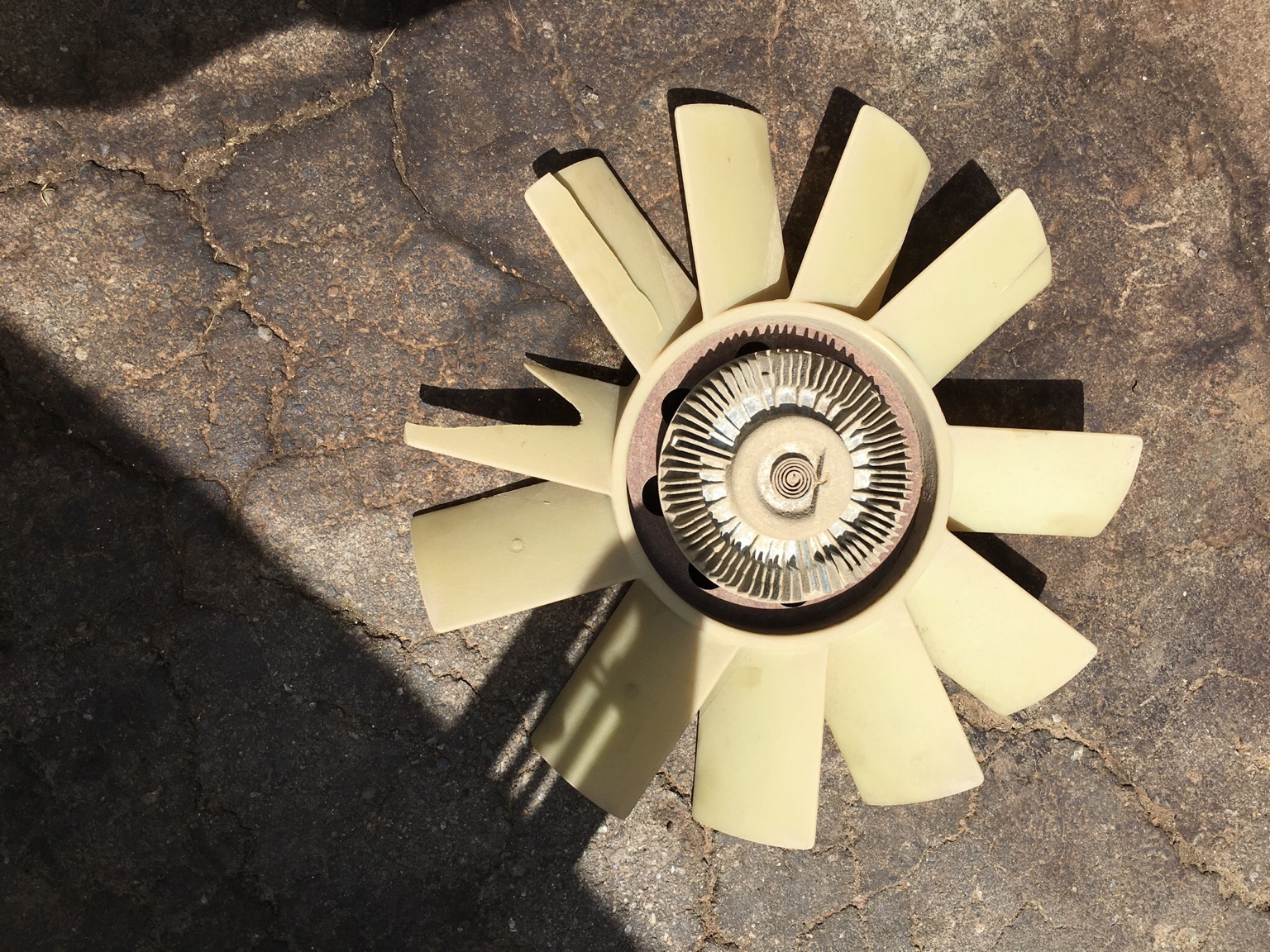

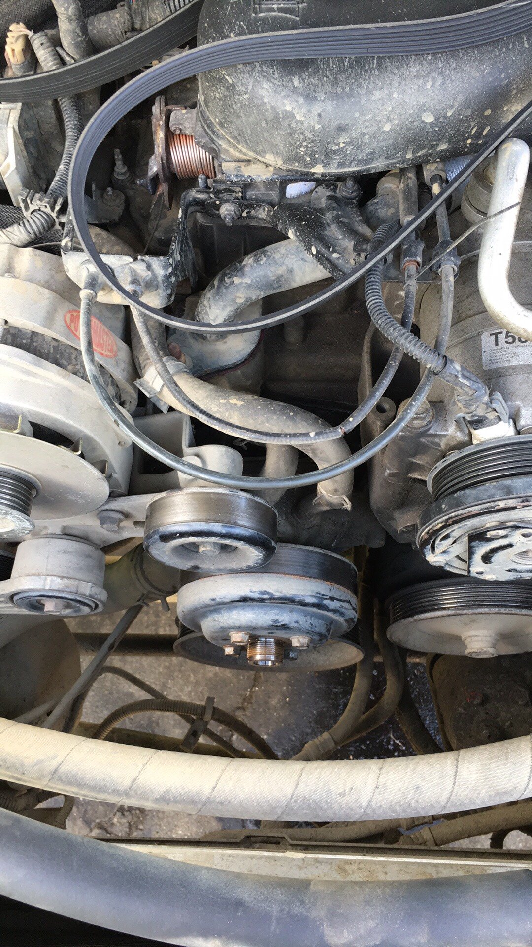

Just an update. It's still ugly. Clutch fan finally too a crap so I converted it to an electric fan. The aftermarket t-case crossmember cracked again so I modified the stock one to work. My Baja Claw TTC's are getting a little thin in the skin so I'll be replacing them soon. They don't wear as well as some other tires but they have crazy traction and I never had a flat.

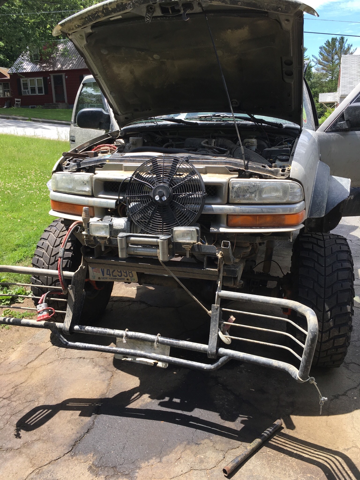

Lol. Mines a cheap autozone fan I've had for years sitting around. I hope it lasts a while. I have it powered through a relay from keyed accessory with a deep water cut off switch.

Well I also changed to a 180 degree thermostat and flushed and changed coolant but she still got hot. I swapped out the fan for a flex a lite. We shall see what happens.
