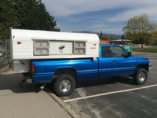

I have a 99’ 2500 4x4 with a 2002’ 24V Cummings, manual trans. Love the truck! Use it to haul any and everything. Soon will put on my camper. Fishing in style with this setup!8E77B627-3FC1-42A2-8696-E54DC2B39253.jpeg7927FBF7-FBAD-4A55-B033-9D0B1F3E5681.jpeg
