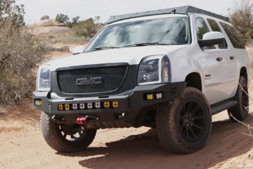

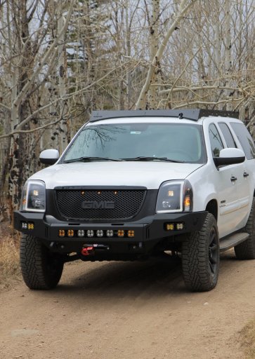

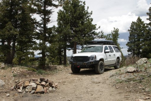

Thought I'd share my current build of my 2007 Yukon XL.
Not the easiest of vehicles to outfit. Happy to share what little I've learned in my long journey to make our family hauler a more capable camping truck.
We're a family of 6, and we always seem to have WAY too much stuff. So we name it "Mucho". It's a lot. We sometimes tow a Tuff Stuff Base Camp trailer dubbed "Mas"
Baseline_Overland_Yukon_XL_Suburban_07_14_Roof_Rack.JPG2007 - 20014 Suburban Roof Rack Baseline Overland Velocirax Chassis Unlimited Bumper.JPG
2007 GMC Yukon XL Denali

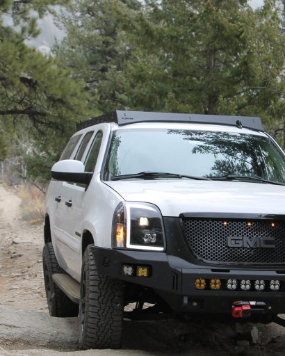

Roof Rack - baselineoverland.com - I made my own after not being able to find anything. Now we manufacture them.
Front Bumper - Chassis Unlimited baselineoverland.com Once again could not find anything, but was able to modify a Sierra bumper to work. Now we are dealer for these.
Warn EVO 12S w/ Factor 55 flat link
Icon 2.5 Coilovers at 2.5" lift front (71505)
Icon 2.0 rear shocks (76526)
Cognito Upper Control Arms
Dobinson 2" lift rear springs (C09-045)
Air Lift helper bags (you need 60912 or 60913 for Dobinson springs)
SDE magneride and autoride delete shockdeletes.com
Redarc Tow Pro Elite trailer brake controller
OptimataYellow Top Battery
K&N cold air intake
JET Performance Throttle Body
33" Goodyear Ultraterrain tires on Vision Turbine wheels (20"). (for sale in the Boulder, CO area)
