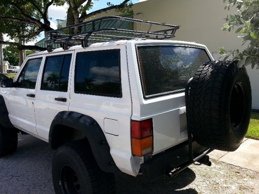

This is mine, when i had 33" tires.... (old pic) I guess the only reason was that i did not a have a ton of money and picked it off Craigslist. It was pretty cheap and it did its purpose so i cannot complain, over 5 years later.... larger tire and a little rust. I can say it has gone beyond its price and simplicity.
