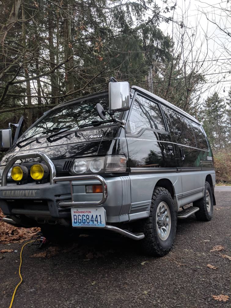

BTW, I have actually replaced tires. The 30" BFGs are a dream, reduce road noise considerably and have already pulled me out of a couple of tight island spots.

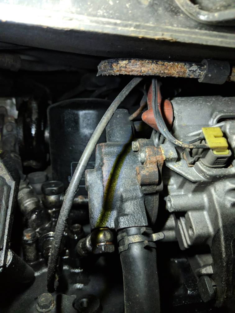

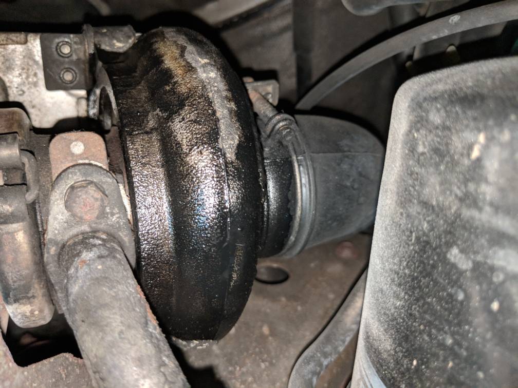

My UK L200 (Triton) runs the same engine - the 4D56. Turbo oil seals always let a bit of oil through. although it doesn't usually end up on the outside :smiley: If it has an intercooler, give it, and the pipes, a good clean out.
Yeah that seems to be the sentiment. Over on http://delicas.ca there are how-tos on the topic. I've got brake cleaner and rags so once it's cleared up I'll be able to isolate the leak. No intercooler here (L300) so somewhat simplified.
I'll keep you posted.

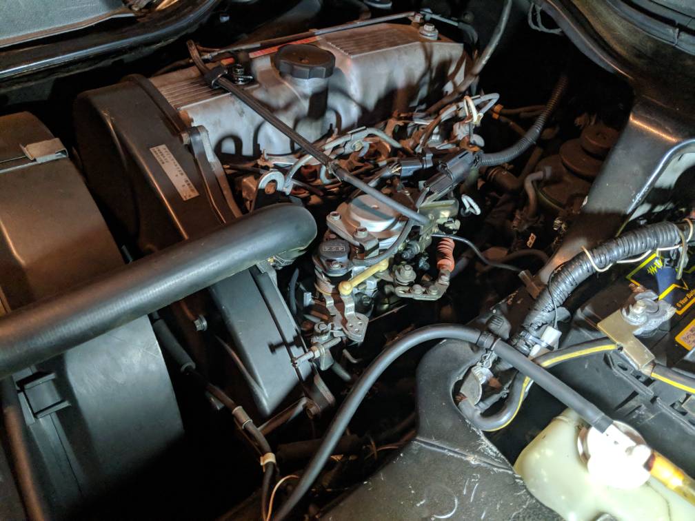

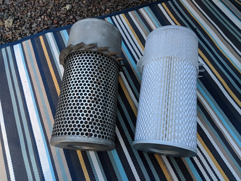

Okay, some good news! Late yesterday afternoon (this far north it was dark) a box came from RightDrive. I thought this was a box of door seals I ordered so I put it in the garage on the workbench and let it chill for the night. When I checked the email from them this morning I realized it was the filter kit I ordered a couple of weeks back. Sweet!
Haven't done the fuel-filter or oil change yet, but I did swap the air filter and holy cow! I now have NO unburnt fuel in the exhaust at start or under load and no power loss on hills.

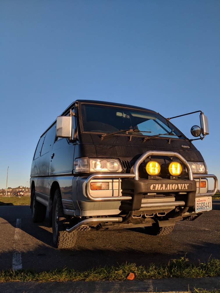

Look what showed up today.

Ok, dumb question time...was that sold originally in the US? I don't remember the Mitsu ever coming with the shortened (non-US) bumper? I remember the bumper sticking out like 3 ft in front (ok, that's an exaggeration)!

How do you like those BFG A/T's? Do they fit on the stock rims with stock height?
I've got a 94' L300 Exceed, was thinking of putting a set on there when it finally needs new shoes.
