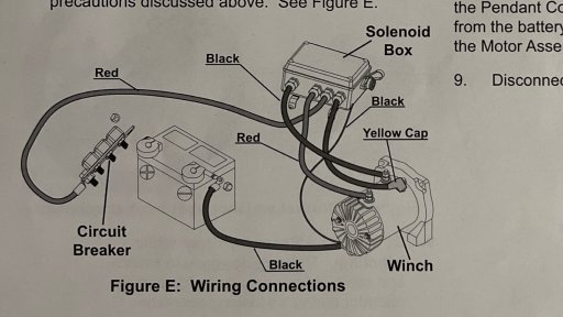

So according to Badlands directions, you simply wire the 12V positive from the winch to that 50x3(150A) relay, and direct to the battery... but it's stumping me because how could 150A work if the peak for the full winch is over 350A? I'd do a 350 but if that's not recommended I don't want to risk frying anything you know? Here's a pic of the wiring diagram.

Cables all appear to be 4AWG true cables that came with the kit
So about 100 amps except for very short duration pulls. Have you found relays in multiple sizes? If the price is close it may be an academic argument. Especially since there’s already a circuit breaker in line.

Don’t increase the breaker size, otherwise the cable becomes a fuseable link.
