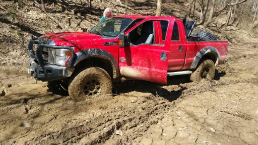

I would buy another one...I still cant believe it pulled that tractor out...looked it up 16,800 pounds.
That weight, dry, level, but with 3 snatch blocks. Yes believable, but....MUD..... I would not have been anywhere near or even want to be near that cable. a 3/8" WINCH CABLE at the minimum, something in a commercial rating would be even better. That whole set-up was working way below a 1.5-....or...- 1.0 safety factor. On a positive note, that Smittybilt was a real TROOPER!

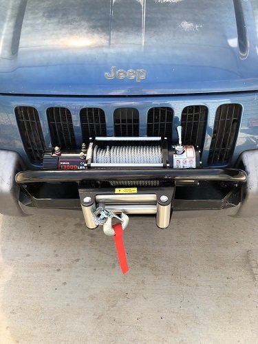

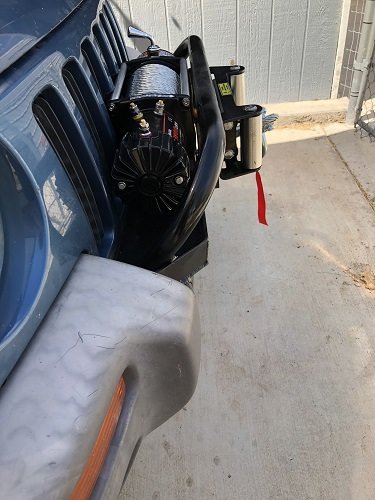

X-Bull 13000 in a custom made mount.....Big winch in a little Liberty!
Not too obtrusive sticking out, unlike some designs. If you had a HAWSE fairlead and synthetic line, that unit would be very trim and tucked in on the front, when viewed in profile.[emoji7]

I actually do, that pick was when it was new, then I found out how heavey the line was and replaced it....
