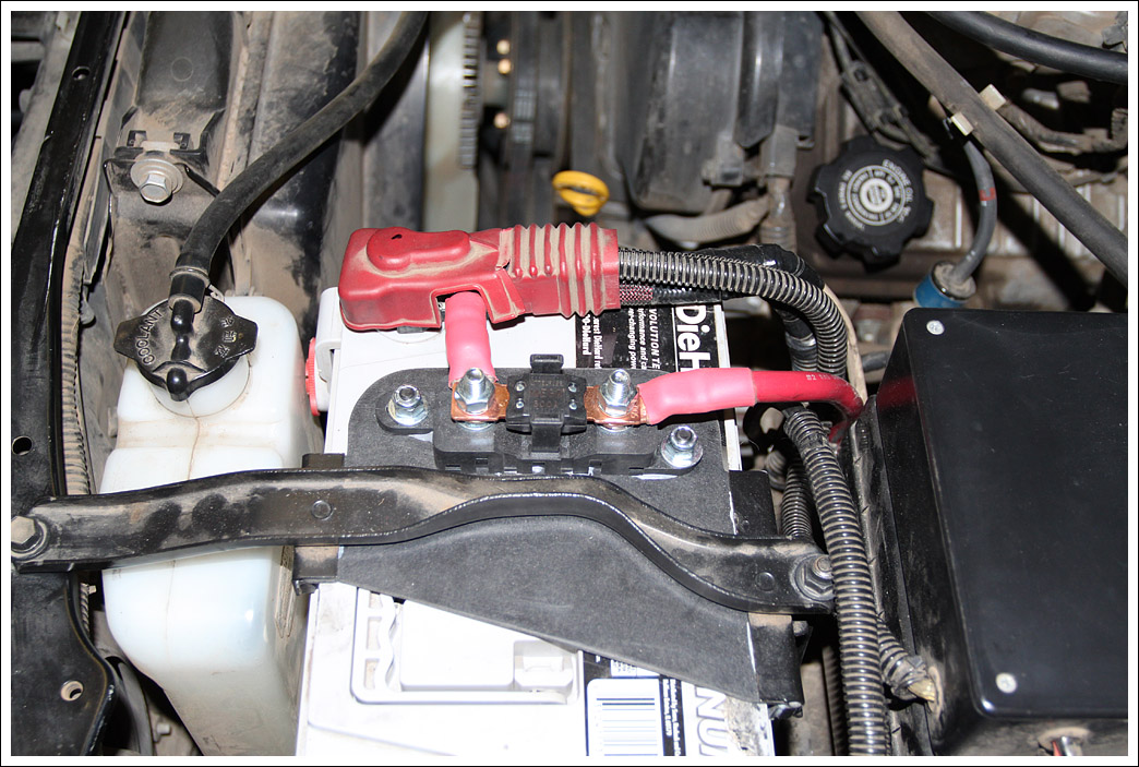

All ready have a 350amp inline, Just trying to prevent the possibility of unauthorized activation, nice mount.I put a 300A fuse inline with my Warn M8000. This way if the positive wire ends up shorting to the frame the fuse will hopefully blow before the truck burns down. The fuse is installed in a way that allows me to quickly bypass it if needed.
Picture is with the cover removed.

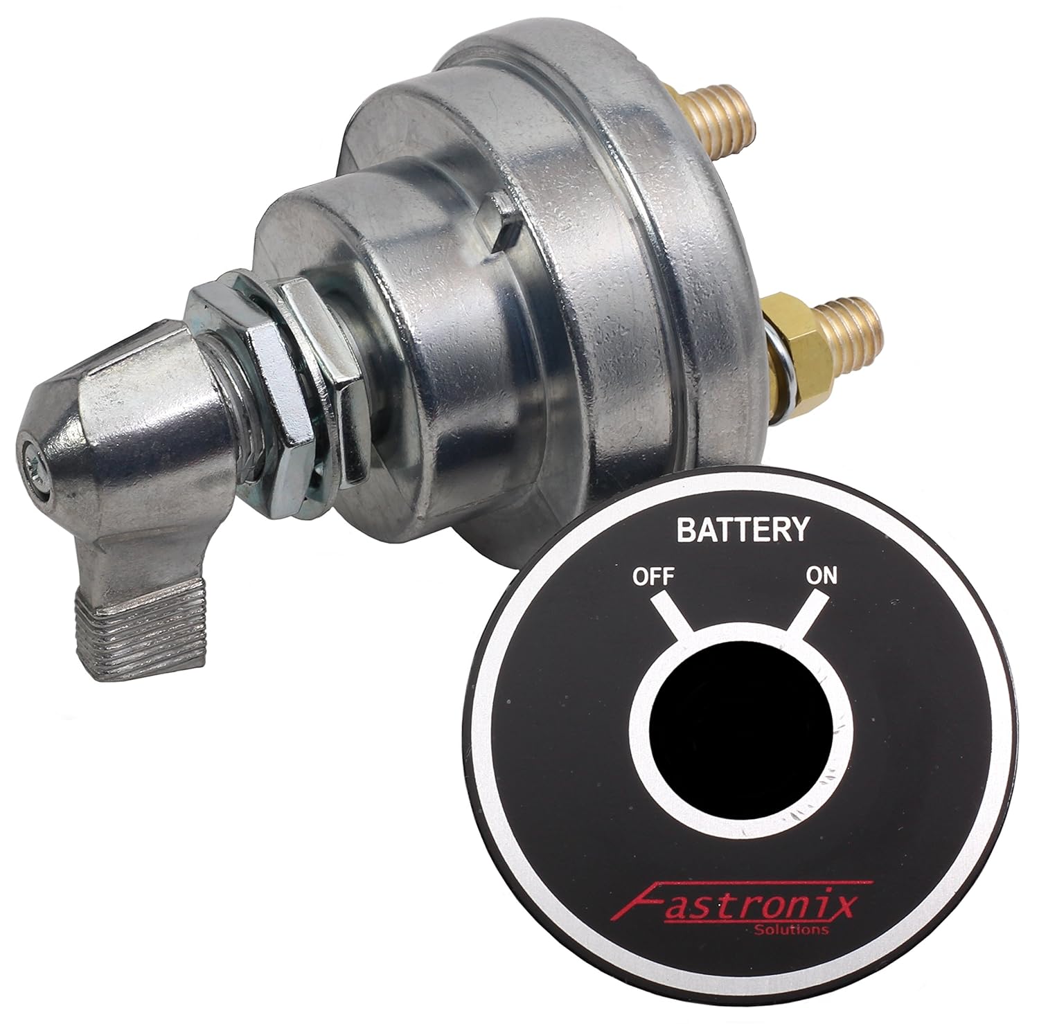

I wanted a switch. Having GM side mount cables, meant more time to loosen and remove vs top post mounts. Having a OEM dual battery setup without a Isolater just complicated the issue. Got mine off of Amazon, mounted on the top bumper wing of my ARB. It also helps with any parasitic currant draw when not being used.All ready have a 350amp inline, Just trying to prevent the possibility of unauthorized activation, nice mount.
Thanks, this would be option "B" for me. I going with a rocker activated solenoid. A pillar mounted with one that is master power for the bank, winch-compressor and inverter. No high draw without the key/engine on. Call me paranoid.I wanted a switch. Having GM side mount cables, meant more time to loosen and remove vs top post mounts. Having a OEM dual battery setup without a Isolater just complicated the issue. Got mine off of Amazon, mounted on the top bumper wing of my ARB. It also helps with any parasitic currant draw when not being used.
Fastronix High Current Master Battery Disconnect Switch with Face Plate
