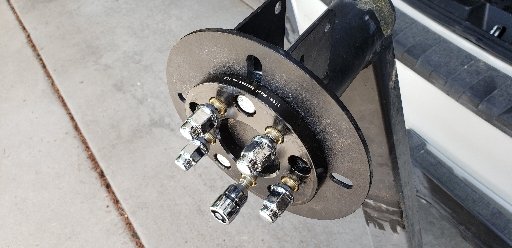

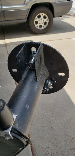

My solution for dealing with the Hitchgate Solo for Subaru (and less than 5x114) wheels... 5x114 to 5x110 15mm wheel spacer.
You'll have to find a stud and lugnut that is large enough for the pre-milled holes... I needed to go for a 14mmx1.25 with enough shoulder to bite into the spacer, but it works and now I have more (and better) contact points.
Wilco could make this so much easier if they just offered this solution for Subi owners at time of order...
