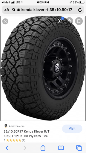

I’m glad a manufacturer is stepping up to offer another 35x10.50 . I think it’s a huge hole in the USA market makes fitting a larger tire so much easier and less destructive to drivetrain not having to fit all that width in there . That size has been available for quite a long time in other countries 9116774E-16F8-4B21-9BB0-DCE56F81DB5F.jpeg

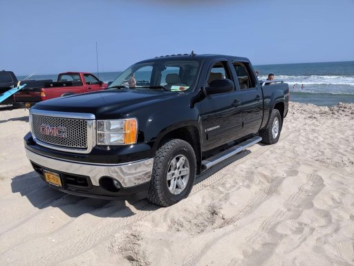

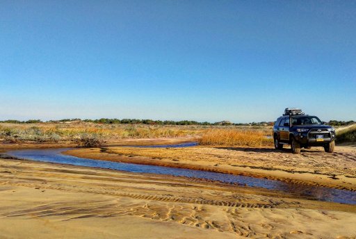

Great to see some folks are using the GMT900 out there. I switched from the "Ideal" overland vehicle to the fullsized pickup for the family, and the bed.
I'm coming out of a '16 4runner.... got out from under the bank and got this '07 Sierra Z71... great truck, just bought an entire new camp setup for it.
15000229_10207480018347718_4781694625563071494_o.jpg22219732_10210119163444696_5908968495580749440_o.jpgtruk.jpg
