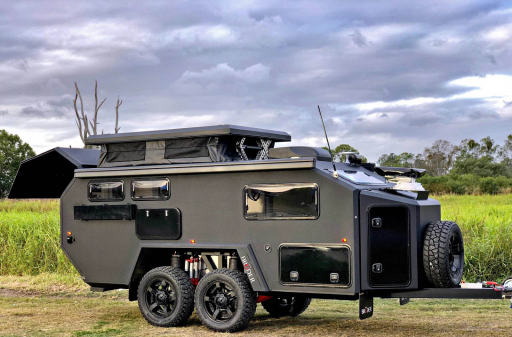

I’m pulling a single axle 4x6. I know if I ever decided to build a 6x12 trailer I’d definitely be going with a tandem axle set up. ( not just dual axles ) like this. Tandems will crawl over things.BEDDBDE4-D02E-4842-B3E0-6D7BEDE3F767.png

OK so I want to ask if you guys have any advice, the wife and I are looking to build out a trailer thinking a 6 x 12 to be a bed bathroom and small kitchen. We primarily camp and live out of our Tacoma but when we bring family along, we wanted to have somewhere that our parents could be more comfortable. So my question is starting fresh and buying a used trailer should I go with a single axle or dual axle? My thought was if I buy a cheap I could take it to my fabrication shop that does good work and maybe they could reinforce the frame and put a better suspension on it and do some modifications but I just don’t know what the best base unit would be to start that? Any advice would be greatly appreciated or if there is a build thread that I missed about the dos and don’ts of starting a trailer build I would love to see that as well. As always, thanks advance!
I have seen the Bruder trailer pictured above and it is awesome, but it is awesome $$$$ too. Check out the off road trailers from these guys. WeeRoll – Affordable, High-Quality, All-Aluminum Camper Trailers. That's How Wee Roll.
Those are cool! Thanks..

I’m pulling a single axle 4x6. I know if I ever decided to build a 6x12 trailer I’d definitely be going with a tandem axle set up. ( not just dual axles ) like this. Tandems will crawl over things.View attachment 244670
Sorry tandem.. ‍♂ good to know…
