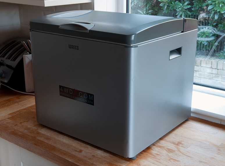

@Steve I did a short write up on ours a couple of weeks ago:
http://4wdx.com/waeco-cab-40-3-way-fridge-freezer/
Mine is a Waeco CAB 40 (Litre) 3 Way fridge/freezer which runs off 12v, 240 or gas. It's been great on the two trips we've taken it on but a lot will depend where you plan to go. This one will cool at 30 C below the ambient temp so for most of Europe it's perfect. If you're heading into seriously hot climates where the in-cab temp is likely to be 60 C+ you'll probably need something with a compressor. If you can get away with absorption cooling then they're quite as a mouse and cheaper to purchase. I bought mine lightly used for $120.
