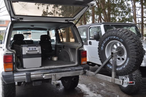

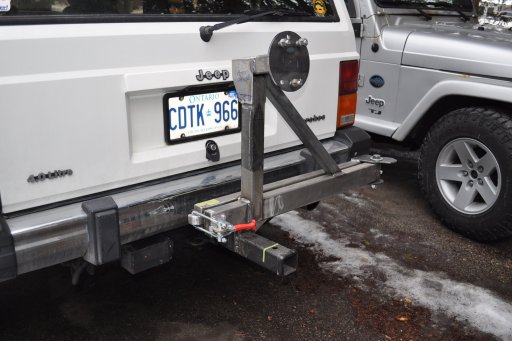

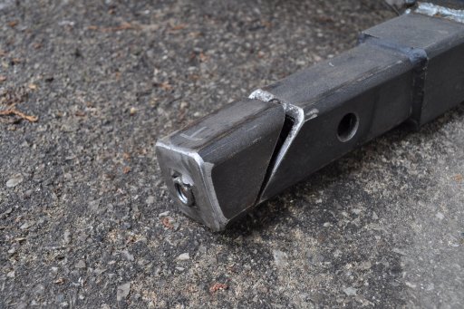

I'm in the process of making my own carrier. I wanted to retain the original bumper on my 89 XJ and be able to install and remove the carrier quickly and easily. I built it so I will be able to tow my trailer with it in place. It's pinned to the tongue but it's also held firmly in place by a tightening wedge (same as RIGD carriers). There's a bit of cutting, gusseting, welding, etc. to do and paint. I won't powder coat it because I'm bound to make a few modifications later. I'm also fabricating a folding table for the gap between the carrier and the tailgate.
I never really considered buying one, partly because of the cost but more because I wanted to have one that is custom for my vehicle.
