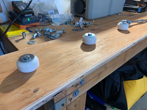

I have three setups - RinseKit for warm water and showers that I store inside the truck and I can plug in to power ( I have 12V in the bed too but that is powering the fridge), a Waterport for spraying off stuff which I have mounted in the truck bed and then I carry extra water in WaterBricks in the bed of my truck to refill the first two as well as a spout on the one I am using to get drinking water out of.
I made a carrier for the WaterBricks after seeing a setup someone had mounted in their 4Runner, I took some cheap roller skate wheels, some nuts and bolts, a couple of pieces of plywood some cheap straps and made a thing I can sandwich three WaterBricks together and slide along the right side of the truck bed. It works pretty well for my set up and gives me a lot of water that is fairly easy to get to. When I want to refill something I just slide it out a little, loosen the straps ad swap out bricks.
Here are some pictures of how I put it together.
