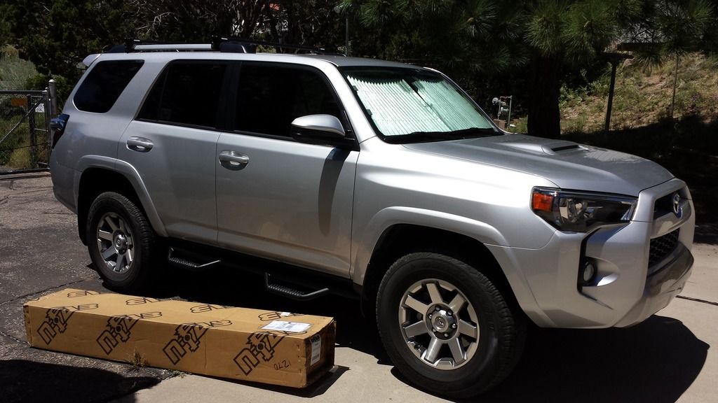

About a week later NFAB streps installed. Also put in Eclipse Sun Shades (seen closed in this picture).

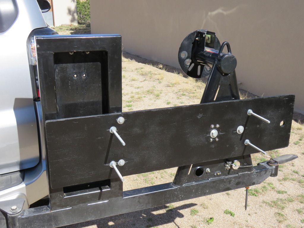

This weekend I finished a carrier for my TRED's on my HitchGate.

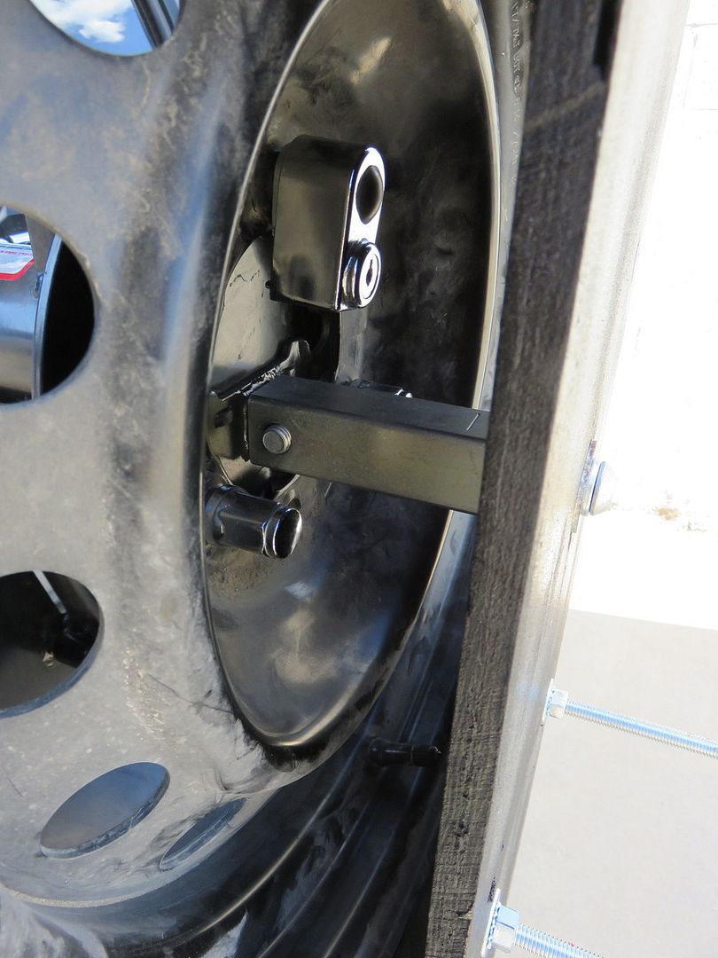

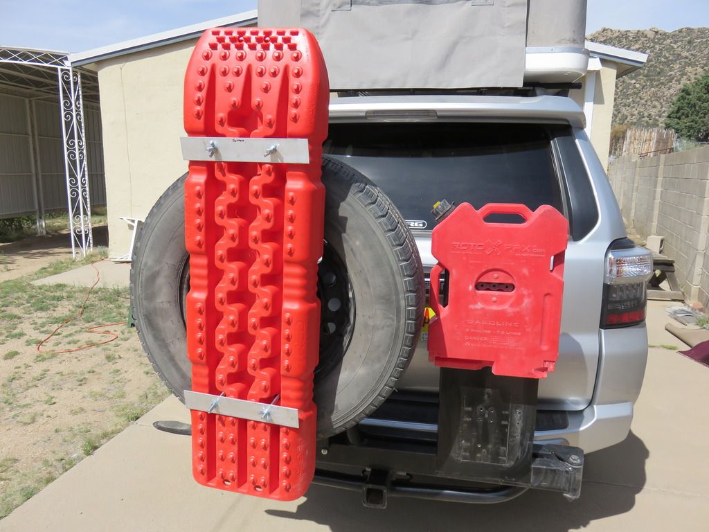

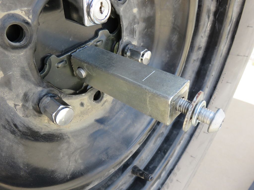

My initial plan was to use Yakima SpareTime parts I acquired to mount the TREDs vertically on the spare tire.

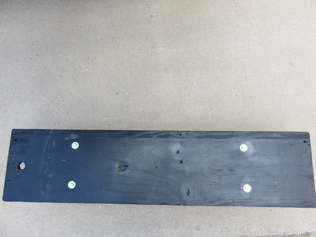

I used some scrap 1/2 inch plywood to make a mount. Sprayed it with bedliner.
Finished mount.........not so fast

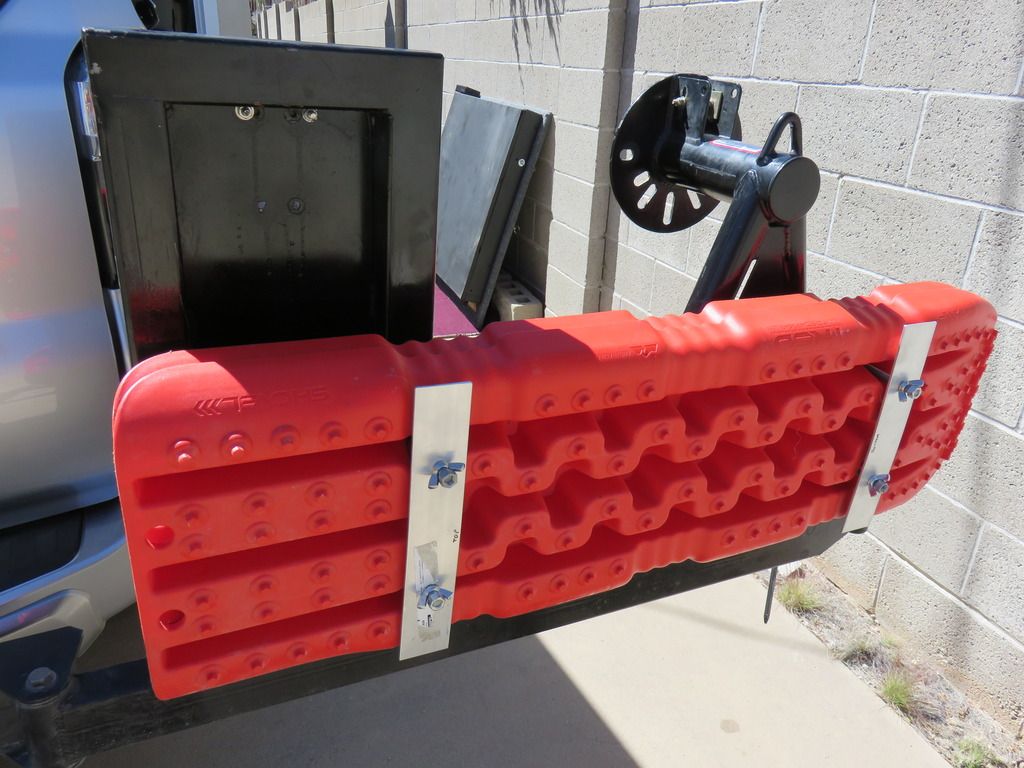

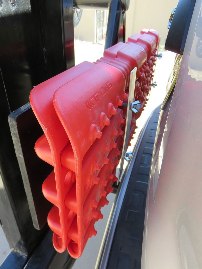

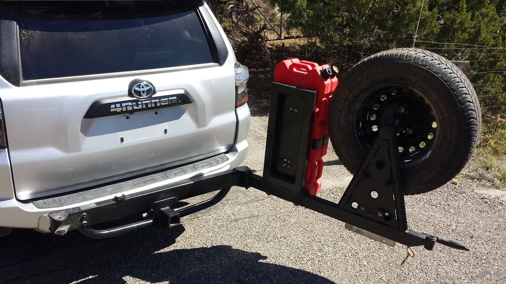

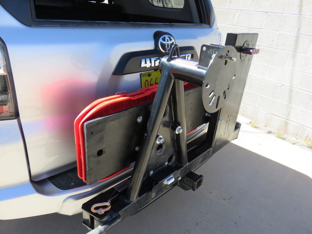

I drove it around a bit and noticed some wind drag with the TREDs mounted that way. I started looking for a different option. Thought of mounting it horizontally, but was concerned that the TREDs wouldn't be stable off road and move around on the spare time. I then thought of using the HitchGate's Hi-Lift Jack mount (2 holes).

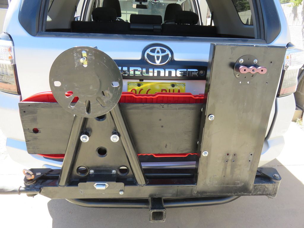

Drilled 2 additional holes in the ROTOPAX gas mount and bolted the plywood mount to the back of the HitchGate.
Now it's very stable and there is no movement at all. No wind drag either.
