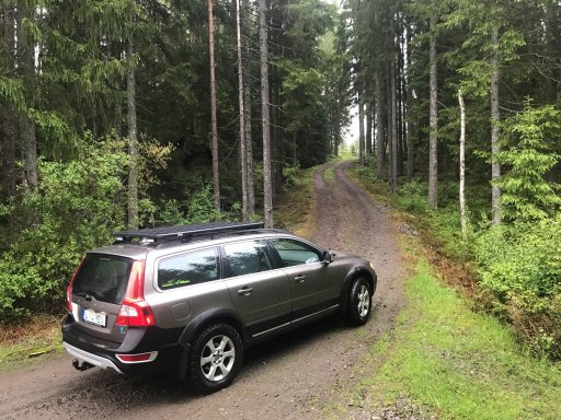

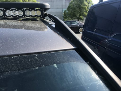

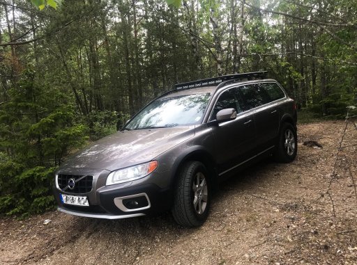

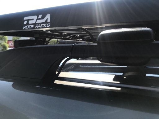

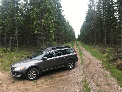

Hello, new member from Sweden. I’ll share my XC70 adventure overland build here. It’s a MY11 D5 Polestar with 30mm lift in the front and 40mm in the rear. Riding on 255/60R17 Continental CrossContact ATR tires adding a total of 50-60mm of clearance. Roof platform from Tola Roof Racks fitted and waiting to mount a good LED-bar on the roof rack.

Also, how did you manage to get the wires for the roof lights through the roof without too much risk of water leaks?

The wires for rear lights are wired under the roof rail foot and in thru an existing hole.
Wires for the front light bar is routed under the foot of the roof rail and down in an existing channel next to the windscreen and comes out at the battery box.
