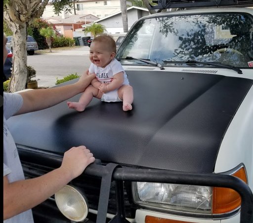

I just cleaned off Plasti-Dip off my hood after about a year of it being baked on there. It took over an hour and a half to get it off with the high pressure washer. My problem was that I didn't put it on thick enough, combined with the heat, I think it just baked itself in there.
If you do a temporary coating, when you go to remove it, and you will want to remove it, make sure it goes on thick enough to make it easier to remove.
I actually had to sand my hood a bit to get the remnants off, so I put on some low-gloss vinyl on in it's place. It hasn't been on there long enough to judge it's durability, jury is still out but it looks pretty good.
Here's the before, just after I finished it, still a little wet in fact.
And here's after (cutest grandson on the planet on the hood, by the way!)
Seems like it's going to be pretty durable, but we'll see. Hopefully it's easier to remove than the plasti-dip.
Dan.
Looking good! I like the vinyl covering the whole hood. Your grandson looks like he approves too. Did you apply it yourself?

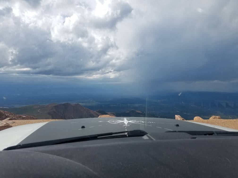

I did the vinyl wrap down the center of my hood almost 2 years ago and it has held up really well to temperature extremes from Desert summer to Montana Winter and many trails scuffs and rocks/bugs. The install was pretty easy (a second person makes all the difference on a big panel!) If you go vinyl make sure its quality and a thicker sheet. I personally only use Vivid or 3M brands for my vinyl wrap. My hood with the additional striping was around $50 total and about 1.5 hours of my time.20170604_175354.jpg 20160821_173021.jpg

I am not much for the carbon fiber look but yours came out really nice and looks great!
