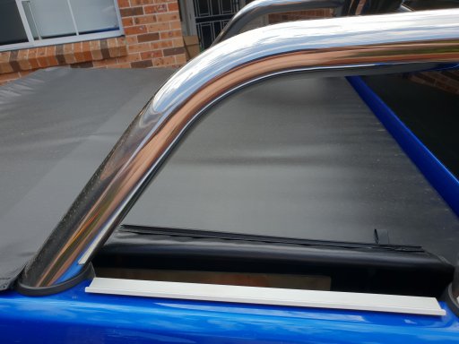

The fridge compressor is at the back of the tub and the tonneau cover does has a little "flap" which I open to help vent heat but it didn't appear to help that much. As per this pic.

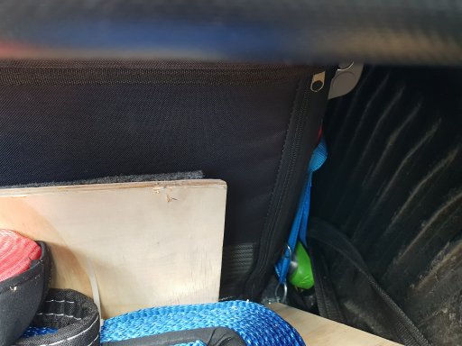

The compressor exhaust is closed to this flap (as in this photo). Has anybody had any experience using additional fans to move the air? I could place the fans adjacent to the compressor exhaust, or I could rig something facing upwards over the gap. Would I be better to have the fans suck cooler air in, or blow hot air out. Will this work or would I need fans to suck in and suck out similar to a computer system. I can get a couple of low current silent 12v 120mm fans which will move 1m3/min. They cost around $15-20 each.

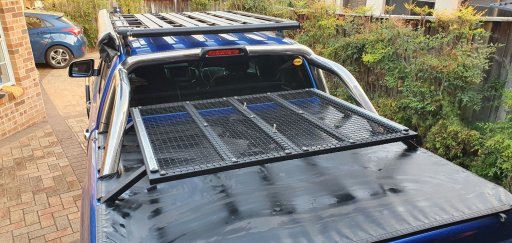

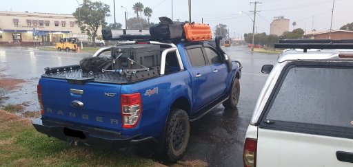

TBH the external sunshade did a pretty decent job. I ended up building a storage rack which sat about 200mm above the tub cover. I was able to fit the sunshade to the bottom of the rack and that helped keep the direct heat off. More so if the rack was loaded with equipment (Photo of rack below)
I've since moved from that and have a solid lid which leave a gap between the surface of the lid and the fridge although the tub is better sealed now so will have to see how it goes.
