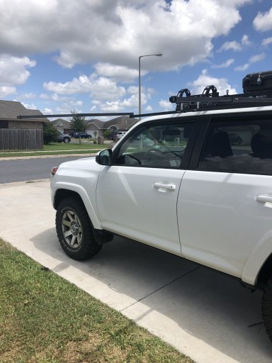

Ok so after much though.... I came across a broken canopy frame. Managed to dissemble it and salvage the legs. Ended up spending a few bucks on hardware and it works surprisingly well. I need to add the fabric. For now I will be using three 5x7 tarps as curtains . The dimensions are roughly 4x5. IMG_0553.JPG
