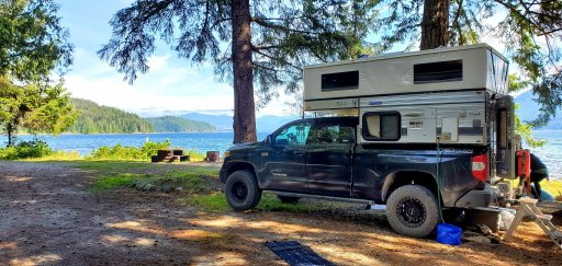

I spent a couple years mulling over our next step when we were adventuring in a suv and rooftop tent. At the end of the day (4 years and many thousands of miles ago now) we purchased a Tundra and Four Wheel Camper. For me, the main advantage over an all-in-one van was I had the choices of what combination of power train and camper I purchased. This also gives me piece of mind if i ever have vehicle issues, or camper issues, then the other is not totally left out of service. The only single perceived benefit I felt that a van had over a separate truck/camper is the vans living compartment to vehicle inside access. At the end of the day it seemed more perceived benefit than real, and was not near enough of a concern to sway my decision.
As it goes, my Wife and I are now in the beginning stages of contemplating our next step. We want something larger, with more comforts, more range, and more payload capabilities to allow us to eventually pursue longer multi-month trips. After lots of considering I still keep coming back to a seperate truck and camper. In our case we will be looking at a large daully (think F-450) and some sort of 4-season traditional camper (such as a Northern Lite). For me, the advantage even here, over a single "adventure-ready" large set-up is the ability to very easily split the camper from truck when staying in one place for multiple weeks.

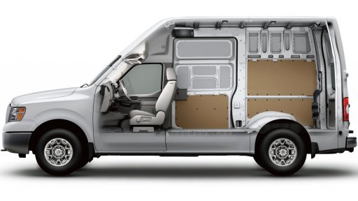

I've often considered a Nissan Van

That's not as capable as a truck. Even a truck with 2500# on it's back. If I get moved into one of those at work, I'm quitting. You have to be very careful with weight in those. If you upgrade to a larger Sprinter that can handle more weight, then you just spent as much cash as an F550 and a camper.
Option C. A chassis cab truck with a flat bed camper box on it's rear. As permanent as the van, triple the room.
Flat bed trucks and tray style campers, give more room, and have a priceless side entry. The downside is that the bed has to be carefully installed so that the trucks frame can flex properly. There's a reason that dealerships will sell a chassis cab truck, but they won't service them. Also permanent camper bodies, should NOT have a cab over bed. The entire camper should be behind the cab, never over it.

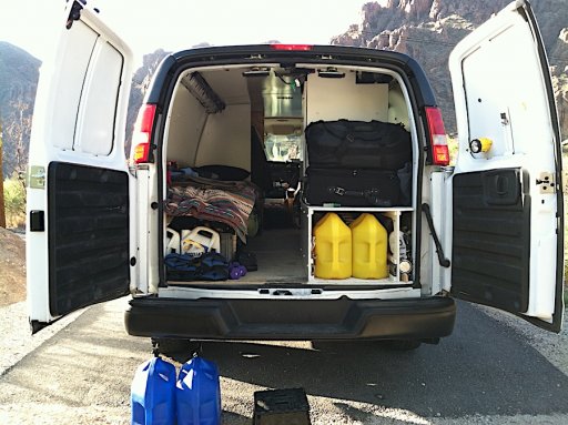

I've used both pickups and vans extensively for adventuring, though have been a solid van guy now for 20 years.
I *really* like being able to crawl in back without getting out of my vehicle. From crashing at road side rests in blizzards to stopping at truck stops or even on a city street, being a little more stealthy is handy at times. My living area is also then at the same temps as my driving area; something not always possible with a slide in camper. It's a real comfort in lousy weather.
With an extended body van, at least in the Chevy Express & GMC Savana, you have about 12' of floor from the rear of the front seats to the rear doors. That's 4' more than a long bed pickup, or 50% more storage and living space. I can put 14' lumber in there and still close my rear doors.

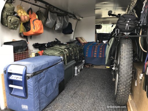

In the image above, I have another 3' in front of the white bulkhead on the left, accessible from the side doors. The bed that goes crossways in this image can be slid anywhere along the length of the van on the built-in sideboxes seen to the right of the bike (and below), set up length-wise along either side, or folded up and stored by the half bulkhead. That gives me an extreme amount of flexibility if I want more space the other side of the bed, want a full pass-through floor plan with bed down one side or the other, or no bed at all.

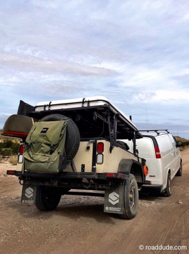

I go everywhere I want with mine, even towing a trailer. It's high clearance, so able to handle every trail I've wanted it to for years.
It's an extended body, so longer wheelbase than many trucks and other vans at 155", which I was worried about at first for some trails. But it has never been a problem yet, and I go all over hither and yon.
Full pass through front to back with a bed on each side, and still considerable storage.

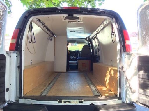

I've used it in a number of different configurations over the years, though always with easily removable units. When needed, I can easily go back to a full-sized van for hauling cargo and helping folks move; materials for building projects; or to use as a solid work vehicle.
Ready for Work.
The side boxes, each having three top lids with finger holes, hold a ton of gear. It's where I keep seasonal items, power tools and batt chargers, tow straps, and vehicle liquids etc; stuff I don't access every day. Storage in the side boxes stays pretty much the same year 'round, leaving my main cargo area free and open. Space measures a full 52" between wheel wells and is over 8" long (those are 8' e-tracks in the floor) if I leave the removable half-bulkhead in place, and almost 12' long if I take it out.
