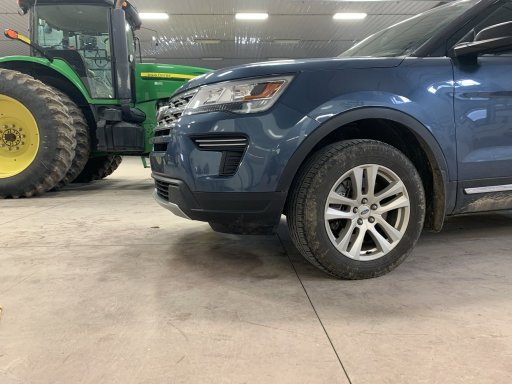

I was also able to remove the front air dam and covered the exposed part of the wheel wells with guards from the Ford Interceptor Utility. This gave me considerable more front ground clearance so I don’t have to worry about a high center in a trail or field debris.
