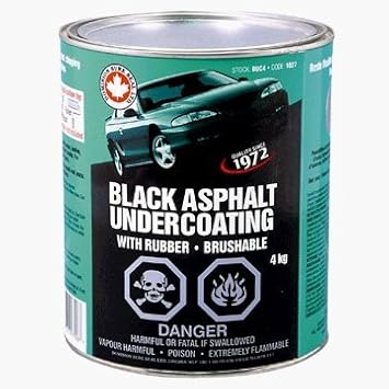

Being in Canada, there is a lot of road salt and rust. Every year I spend half an hour and spray the underside of my car(s) with "Asphalt Undercoating". It comes in an aerosol can for about $10. I've never needed more than two of them to do the underside of a vehicle. The asphalt is oil based and repels water. It's like putting wet tar on the underside of your vehicle. It stays tacky for a while but over time it dries out so that's why you need to re-apply. If I spray it in the fall, it's easily dry to the touch come early spring. Just spray it on the sheet metal and try to avoid the mechanical stuff as best you can. I find it to be extremely effective.
It comes in an aerosol can or brushable:
