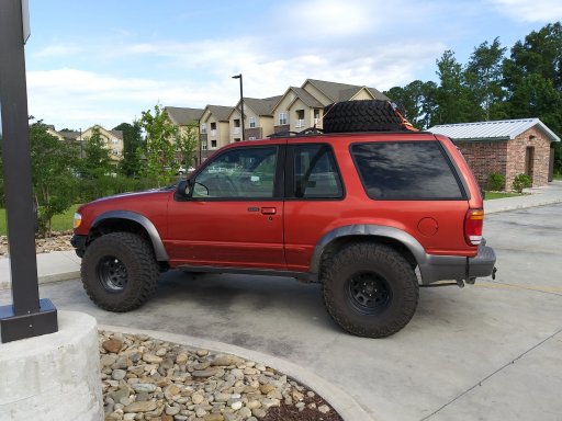

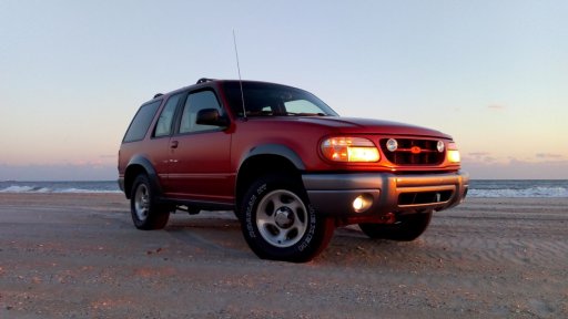

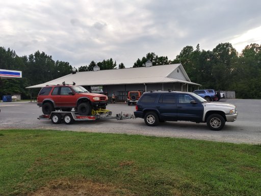

@Zagha725 What's wrong with a 1st-gen Durango? Instant Dakota SUV. I use mine to lug my 2nd-gen Explorers around (both the hated SOHC's, no timing chain noise at 190k and 220k, yes I have two of them) and have camped in it before. Big and small at the same time, very maneuverable for its size (Explorer is much more nimble) and if you get the 5.9L they're about invincible. Just keep the oil changed and plan on a new water pump every about 120k. For whatever reason mine chews through tensioner pulleys, not sure if this is a common problem. The aftermarket is limited, but lift kits do exist. Look for one with the 3.93 gears if you want to run oversized tires. Mine has 3.23 gears and they're taller than I like.
2nd-gen Explorers are too varied to just say they're good or bad. And they're so common that thousands of doofuses who ignored maintenance and didn't understand physics, destroyed them through operator error. The bad rep is largely subjective. The SOHC isn't the problem - poor maintenance practices are the problem. Tough luck finding one that has been maintained half decently, under 250k. If you do find one, either get the V8 or make sure it has 4.10 gears, or you can plan on regearing if you go bigger than 31's.
If you have specific questions about either, ask away, I've been building both a Durango (read: Dakota) and an Explorer for years.
