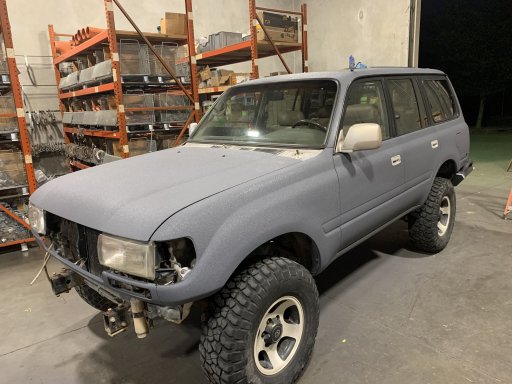

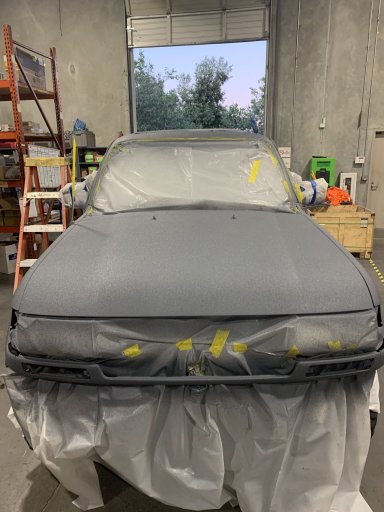

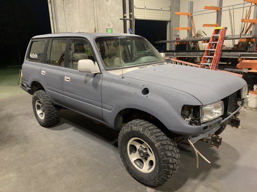

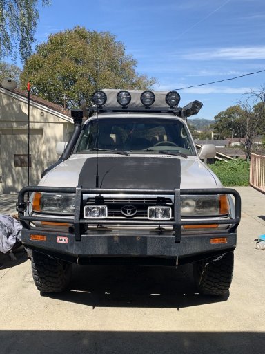

Tintable Raptor Liner is going on. Body will be Battleship Gray. Bumpers, sliders, odds and ends will be standard black. 2D1668C2-2DEB-4E92-8B18-4D3AE0FA4565.jpeg

Nice Cruiser. I absolutely love mine. I don't even want to know how much I have invested in time and money.
You doing the whole vehicle?
I did my M-100 in Raptor and my lower body lines and sliders in Monsta Liner.
The trailer was sprayed, the cruiser was rolled with course roller and the sliders were a fine roller. I preferred the spray or fine roller texture. I'm building a new trailer and it will be sprayed Raptor.
I made a mistake when I did the Raptor, I didn't sand it with a low enough grit. No finer than 200 grit. If you don't, over time it will chip. I got that from Raptor. That's what I get for watching a U-Tube video on prep and spray.

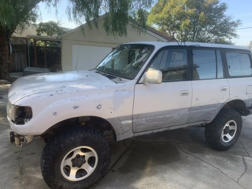

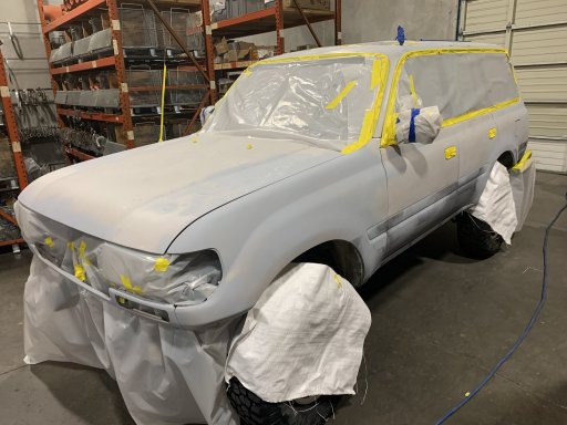

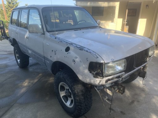

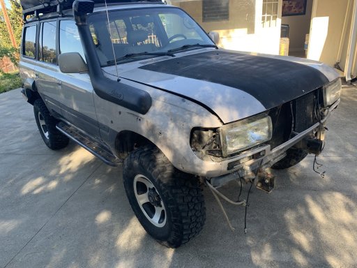

Doing the whole vehicle roof to rockers. All prepped with 120. I had a ton of clear coat peeling so prep has actually been a bit of a pain. A lot of areas I had to go deeper that you would if your paint wasn’t crap. Also found a bit of filler I never knew about on the passenger side. All of this will be sprayed on. I have done a ton of Raptor research. You can find a bit of conflicting info o different peoples DIY efforts. Like anything, the quality of the result is all in the prep. I am hoping to spray the body today but after a washing last night I found several areas that need a bit more blending. I also have a lot of ares that are down to bare metal and need to be hit with a primer.
One thing I am hoping will help long term is that I am using all Upol product. Their primer, their wipe cleaner and their adhesion promoter on my plastics and powder coated parts. We will see.

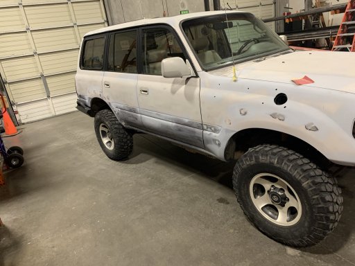

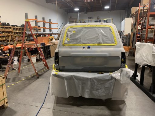

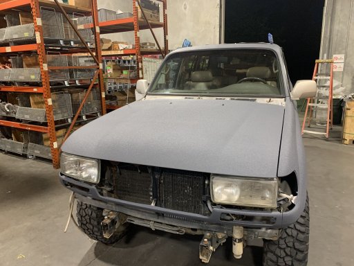

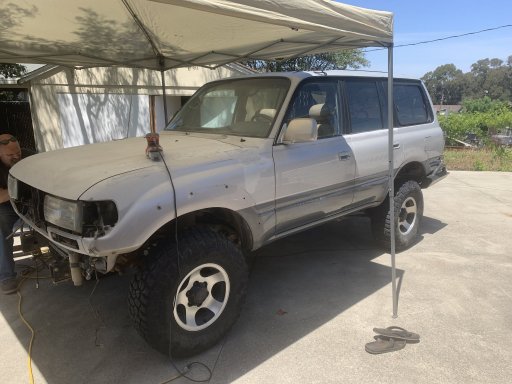

Well, one fix led to another. Also decided to fill all of the fender flare holes. Tomorrow, it gets shot with liner. The rear bumper is installed in a manner that we will say is... unremovable. So that means I am spraying around it and then spraying the bumper while it is on. We will see how it goes.

Knowing that nothing happens on its own I arrived at the shop early Monday to get crackin’. I quickly found out a few things. First, I am not all that great at estimating how long tape work takes. As they say, the end product is all about the prep so I wanted to get this right. Second, some things are easier with another set of hands. So I called in the best help I have, my wife. She is more patient than I and is all around better at detail work.

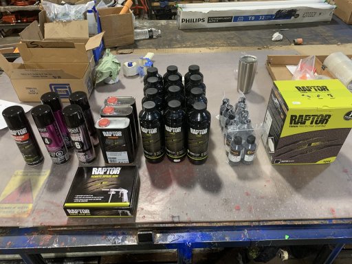

Next on deck was making sure I had everything I needed to get this done in one shot.
Amounts required from all of the experts on the interwebs varied wildly from 6-12 bottles. I figured I’d buy the 12 and figure it out later. The black four bottle kit on the right is for the bumpers and whatnot later. I also used Upol prep product as shown on the left as well.

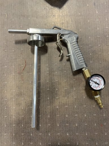

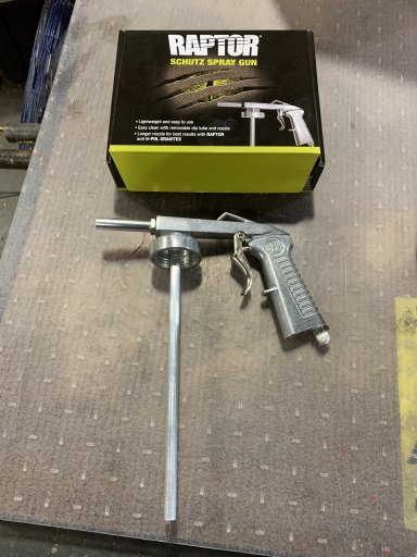

The spray gun they give you in the kit is pretty dang basic. There are upgraded ones you can buy but I chose not to. 59E4AF5B-99A3-4306-8D24-BBC1006A354B.jpeg
I did however decide that it needed a regulator at the gun to easily adjust line pressure.Twenty bucks and a trip to Lowe’s later and I was in business.

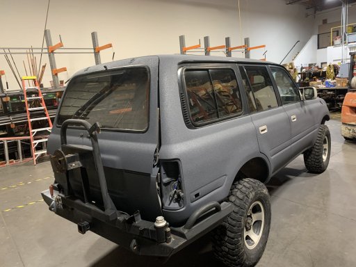

I imagine it is hard to take pictures of yourself while you spray this stuff. I didn’t try. I did however take a few mid process shots. 70BA06ED-C76E-44CF-8981-FA60710DAD5C.jpeg
It is pretty amazing how forgiving this stuff is to work with. You can build new texture over old texture and change it. Blending blemishes is fairly easy. A bit to heavy and you can clean it up pretty easy on the next pass.

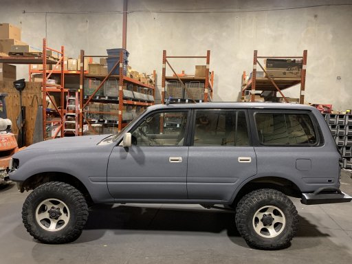

There is no real definitive information I could find on when you should pull tape and masking. I just waited about the same time I had been waiting between coats and had at it. Everything came off pretty easy.
78772064-4E68-4C25-9819-C6DA5D331574.jpegA1BF538C-0717-4DFD-8A75-403428B14CAA.jpegF01FC1FF-EA6A-47CF-8E5D-307F8E4FFDCC.jpeg605A63E5-5A7C-45D0-8F10-677D15F10A2C.jpeg507A9FB6-F876-4517-B0A4-2ABFE844503C.jpeg

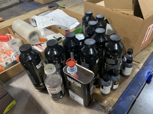

In the end I ended up using 9 bottles. The 3 I have left is more than enough to do all of the jams if I get bored one day as well as the inside rear tailgate plus have a two bottles left for touch up/respray if needed. Who knows, perhaps I’ll have some other project to spray. Could always buy different tint and have a different color. A1A943E9-7DEE-4DD9-ABE1-C9A98F53BBB4.jpeg
