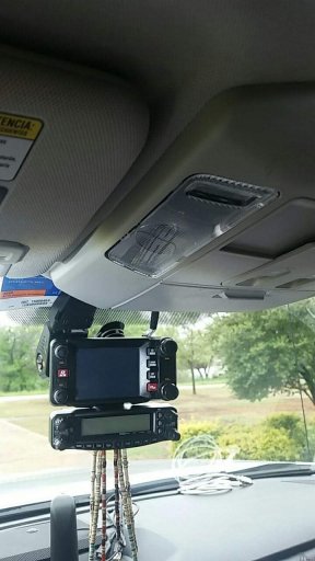

I'm assuming you added the 8900 just for 6m and 10m capability. Regardless I have come to really like have dual radios in my rig.

No, not really. Outside of monitoring multiple freqs during an event, I like having the aprs on the 400 along with some of its other features.

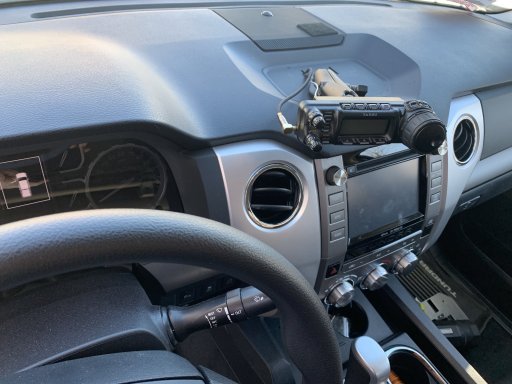

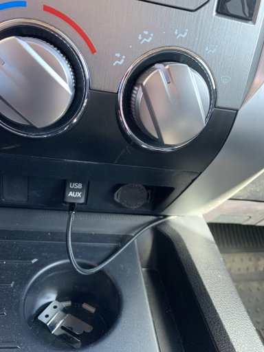

I finished installing my FT-857 into my truck but still need to add to it as I go. So far only using 2m but it seems to be working pretty well testing it with a repeater 80 miles away from my QTH. I am running the headphone jack to the AUX into the stereo so I can listen to it through the radio speakers and it sounds great. Any and all questions, comments and critiques welcome. Thanks for looking, Brian

That’s pretty slick... where exactly did you mount the radio it self? I’m looking for an inconspicuous spot in the wife’s 4Runner...

Thanks,I routed everything to fit under the backseat since it lifts up for easy access and hopefully stay cooler.
