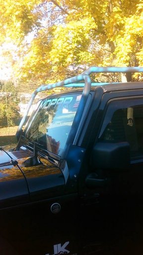

Depends on your project. I bent 1 1/4" pipe for my roof rack. I would think 3/4" or even a 1/2" would be good size for say a cargo rack. Bumper style tubing is much larger at around 3" which most home style benders cant handle anyways.
