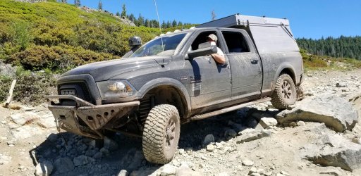

I shall ride to Valhalla shiny and chrome!
The Power Wagon is a hog on fuel but a warthog on the trail. Its ugly, big, and I often get told on the trail I won't make it, and it crawls right over the doubters. Not much will stop her, and that's what I bought it for. It's solely used to getting to trails and up them. I regeared 5.13s, nothing but M/Ts, and I'm about to cut the front rocker panel for 40s.
Honestly may even twin stick for front digs...but the Rubicon wasn't an issue. Swamp lake me get me in the pinch turn, won't know until I try.

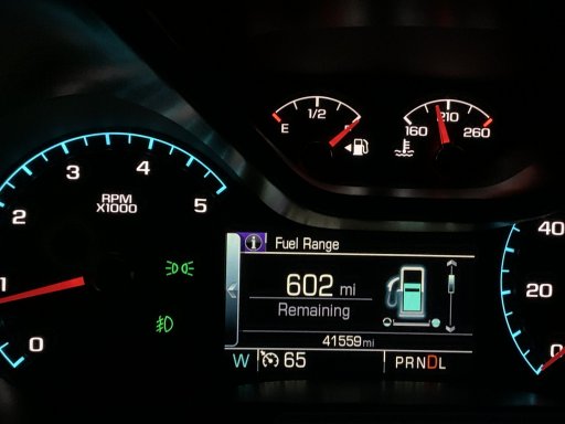

Depends on the mid-size truck, some are much thirstier than others. If you want to get some "real world" data then check out the fuel economy logged on fuelly.com.
Colorado V6 ~20MPG average - Chevrolet Colorado MPG - Actual MPG from 182 Chevrolet Colorado owners
Colorado diesel ~24MPG average - Chevrolet Colorado MPG - Actual MPG from 146 Chevrolet Colorado owners
Ford Ranger ~20MPG average - Ford Ranger MPG - Actual MPG from 677 Ford Ranger owners
Jeep Gladiator gas V6 ~16MPG average - Jeep Gladiator MPG - Actual MPG from 107 Jeep Gladiator owners
Jeep GLadiator diesel ~20MPG average - Jeep Gladiator MPG - Actual MPG from 4 Jeep Gladiator owners
Nissan Frontier 4.0L ~17MPG - Nissan Frontier MPG - Actual MPG from 1,116 Nissan Frontier owners
Nissan Frontier 3.8L ~17MPG - Nissan Frontier MPG - Actual MPG from 11 Nissan Frontier owners
Toyota Tacoma 3.5L ~18MPG - Toyota Tacoma MPG - Actual MPG from 1,940 Toyota Tacoma owners
So while there are SOME mid-size trucks that are in the mid-teens on average not all of them are, and to say that once they're loaded for overlanding (no trailer) you'll be getting 10-12MPG that may be true for SOME of them, that is not the case for all of them. Can't lump them all together.
My Canyon with the Duramax averages 20MPG with the RTT on the shell, the bed loaded with gear, and 3-4 people in the cab. No RTT and a combination of freeway, city, and country driving I average 24-25MPG. Freeway-only I get 27-28MPG. For long road trips I can get 600 miles per tank if I push it (which I don't). Truck has a 21 gallon tank. A 600-mile range works out to 28MPG or just over.
The only time my fuel economy ever got anywhere near 15mpg or lower was when towing a 5,000LB, 10ft tall, 8.5ft wide travel trailer with a nearly vertical nose. Towing that at 62MPH I'd get 12-14MPG.
But, diesel isn't for everyone. I'd just be careful when lumping mid-size truck fuel economy in with full-size trucks, often times they really aren't that close. Even when comparing gas versions.

It's all moot anyway because I'm not going to tow! I think the ZR2 Bison gas is 18/16 which is probably pretty normal for 33s, lifted, with armor. Or a stock Tacoma TRD OR :sweatsmile:
