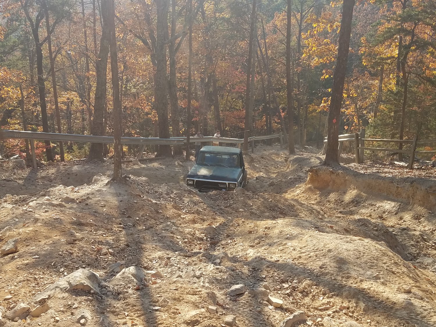

We picked a few easy trails to get Andrew (Matt's little brother) acquainted with his Jeep and just a little taste of off-road driving. I remember we ran Dickey Bell from top to bottom and Falls Dam. At the end of Falls Dam we ran into Wolf Den, then down to Slab Pile and back to the 553 Access Road on the south end of Rocky Mountain Loop.
Here is Matt's truck and Andrew's Jeep coming down the hill top hill climb on Dickey Bell.

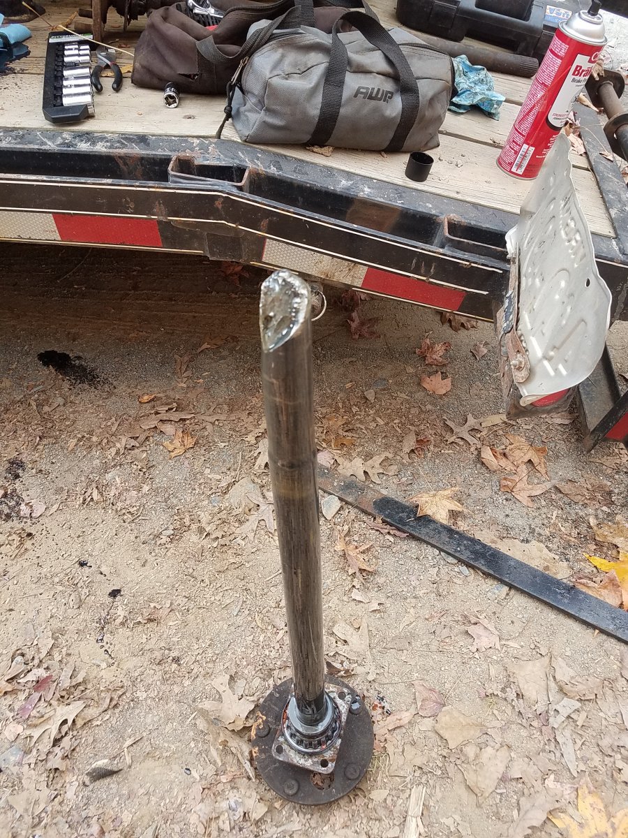

Back at camp, about noon like we had hoped, we started tearing into the truck. We pulled the shaft and were pretty impressed with what we found:
full

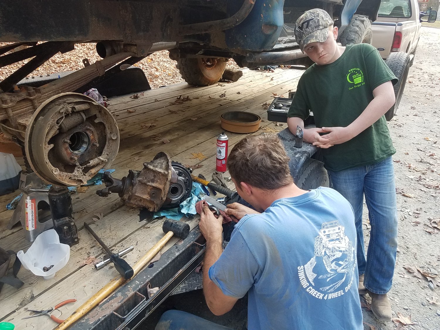

I got to work cleaning up the new shaft to put back in and Matt went about trying to pull the stub out. *clank* "What was that?"
Matt: "Um, I think we're going to have to pull the third out, the spanner nut appears to have been torn out of the third member."
Me: "Uh huh..."
We tore the other side down and pulled the third member out of the truck and found that when the shaft broke, it had forcefully removed the spanner nut on the carrier bearing on that side and wedged the broken stub in there. It had also deformed the carrier and made it impossible to remove the bearing in the future without turning it in a lathe.
Well, now what? "What do we have to lose putting it back together and trying to run it? We've got a trailer and nothing but time!" was the consensus view. By this time, our friends were back and we had also been joined by some guys we had wheeled with there almost a decade ago who recognized the truck and came over to say hi. This isn't the first of our trail repairs along these lines and won't be the last so Matt and I were confident it would work, at least in the short term.
So back to it, Matt was driving the stub out of the carrier with Andrew's help and I was now cleaning up both spare axles in case the passenger side axle had been weakened as well.
full
That's Brett's son watching Matt work on the spanner nut:
full
We tried to thread the spanner nut back in once everything was ready and it wouldn't begin to start. We decided to loosen the cap and push the nut against the bearing, then tighten down the cap to hold it in place since it was egged a good bit. First try didn't work, the bearing was too loose, way too much backlash. So we got a hammer and drove the nut in, holding it in as we tightened the cap. Success! Backlash back to runnable tolerances, at least in this situation. So we stuck the third back in and Matt tightened it while I put the axles back in and after a refill and final recheck, unloaded the truck and were off.

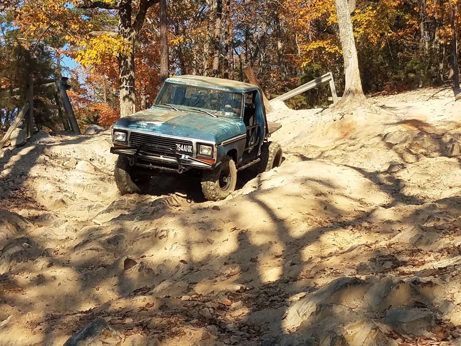

This time we decided to run Dickey Bell from the bottom up and then decide where to go from there. At the bottom of the climb, there was a traffic jam of Jeeps and Land Rovers and 4wheelers. One of the Rovers had blown a front axle and was deciding what to do, the Jeeps were just going up then back down and trying to leave. We asked around and decided to just push through since no one was on the obstacle. Andrew was having trouble with the little Jeep and Matt volunteered to drive it up for him. It went right along after setting the idle up so it wouldn't stall as easy. I'm afraid I don't have any pictures of this since I was spotting for him and no one else was using a camera.
Next was the big Ford's turn:
Ledge at the bottom:
full
full
I don't usually have to spot the Ford any more unless it's really hairy or a big rock garden, so I got to take pictures here.
Ford strutting it's stuff:
