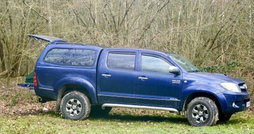

Its been a year since I bought the Hilux and after a few building projects (from the boss) at home during lockdown last summer I ran out of time and was told to go back to work. This summer is finally approaching and I am wondering what's the best treatment for the frame? I am hearing good things about Dinitrol but I have no experience with it so I thought I would ask the community and see if there is a better option or if anyone has any recommendations?
