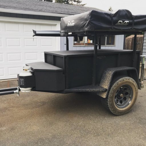

I ran a RTT on my XJ's and then the LJ I have now but room was always at a premium. After a really wet trip down the Oregon coast in 2017 the wife green lighted a trailer but money was our issue too. I chose to build one and am still tweeking it constantly. The bottom line is I wouldn't even consider not having it! More stable for the RTT and we take everything and anything we want. Though it isn't "sealed" it is pretty dry (a little water finds it's way in around the rear door) and I don't worry about gear going in wet or not since it isn't in the Jeep with us. So far no problem getting anywhere but I built it and pack it balanced enough to disconnect it and move it by the tongue if necessary. Used ones can be had but prices have gone up at least where I am in WA, COVID tax it seems. I say invest in one and don't look back!
