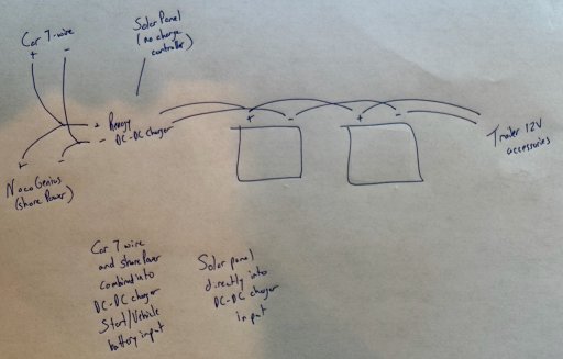

I'm brand new to trailers and solar, and am hoping someone can check my setup so that I'm not about to do something stupid. I've got a Taxa Woolly Bear (2021) that I'm going to expand to a dual battery (parallel) system on. Everything in the trailer is wired for 12V DC - no AC and I'm not anticipating a need to change that. My needs are pretty light and I'm more interested in extending time to depletion on the batteries with solar instead of being able to fully recharge them.
My goal is to have a system that I can charge either with shore power or a solar panel depending on what's available. My current plan is to tie together the input from the 7-wire and an on-board battery charger and plug that into a DC-DC charger that will also accept the input from the solar panels. Then the DC-DC charger is attached to the first battery in the bank. Is this the right way to go about doing this? Is there a better/cheaper way to do this?
Additionally, I'd love recommendations for a power cutoff switch to install between the batteries and the trailer's power panel to completely kill power during storage to avoid parasitic drain from the control panel.
Here's the shopping list I've got (about $450 in parts, excluding a new battery box and second battery):
AC port plug: NOCO - AC Port Plug - GCP1
Battery charger: NOCO - 1-Bank 10A On-Board Battery Charger - GENPRO10X1
DC-DC battery charger: Renogy 40A DC-DC Battery Charger with MPPT
Solar panel: 100W Portable Solar Panel

AFAIK there is no 1 unit that does it all.
I use a RedArc Trailer S for charging off the 7 pin, it also can charge solar.
For shore power charging I have used NOCO or Xantrex units. NOCO sounds best for your application.
After conversion to 12VDC, this all goes to a Circuit breaker and then Blue Sea panel for distribution.

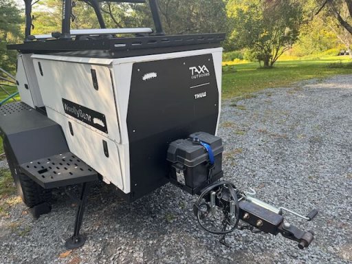

I've finished the build (it took a bit because I had to have a battery box custom built due to the short length of the trailer's tongue).
Here's what I ended up doing (labeled picture of the battery box attached):
View attachment 286754View attachment 286755
nice set up. ive been using LiTime for a while now and did a build with the same battery you have, but i just went with their 20A charger instead of the 40. i have a black metal tongue box and it gets pretty hot when in the sun, so i did add some extra vents (stainless marine vents for boat) and debating if i need to add a 12v fan in there to make sure im getting the hot air out fast enough. it gets well over 100 degrees here in the summer, but unless you go out west during the summer, you will probably be good temp wise
very sharp install!
very sharp install!
I went back and forth quite a bit on the 20A vs 40A charger. Ultimately, with the style trailer I have and the camping we've done with it, I know that having access to shore power is uncommon and I wanted the extra charging speed when it was available.
I've got a temperature sensor that I'm going to toss in the battery box in the spring. I'm not super concerned for local camping as a really hot day is 90°F here. The battery's operating temperature is 4°F - 140°F (though charging max limit is 122°F). I suspect I'll ultimately end up adding an additional vent in the future - 15 years ago I tent-camped my way around the West and would love to do it again with this setup. If you've got a good recommendation, for the vent, I'd love a link.
