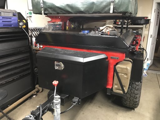

image.jpg I am in the planning stages of my electrical for my trailers HF tongue box. After days of research, (it feels like it anyway) I have a pretty good plan for what I would like to power. My build isn’t extreme, I don’t need to power much. I’m uncertain about some of the build as of yet. Generally, I scour forums and put together a build idea of my own based on how others have done theirs.
The biggest draw on my entire system will be a fridge. I am planning on a Dometic CFX50W. I have read that I can leave the fridge plugged into 12v and 110v constantly, as it has a built in voltage sensor that automatically switches it to the most efficient source. So, I can just unplug from the wall, the fridge will run off 12v until I return home and plug an extension cord back into the tongue box. 12v will be supplied by a AGM battery.
My plan includes a Noco Genius port plug, I think I will wire it directly to a gfci outlet. The fridge and a ctek battery charger/maintainer will be plugged into the outlet. The Ctek will be wired to a AGM 80ah-100ah battery. A circuit breaker, fuse panel, ground bus, and shut off switch will follow. (Not necessarily in that order) I will need a couple switches, and a Powerwerx 4 hole panel with a switch, 12v plug, usb charger, and voltmeter.
I have not decided how I want to mount all this in the HF box. Others have just drilled holes, and some put pieces on plywood against the walls of the box to screw components on to easily.
How do you have your electrical setup? And what would you do differently?

I got started on my electrical box today. After a ton of research, I found that the Durastart marine agm is the same battery as the Duracell rv agm, but $65 cheaper. Both are made by East Penn, who also make Mid-states. AE6A0ADA-DD32-4746-8F95-B83B4F2374E7.jpeg
My parts from Powerwerx showed up today, so I got busy installing.
I had one screw up I will take care of later.
More to come!
