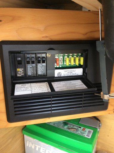

27259125-328E-43B4-994B-0A24DE31E759.jpeg 7B0520E4-BC58-4794-996E-806FDA7C8819.jpeg Hey captain not sure if this will help but I used a progressive dynamics power control center model # PD4100 and did a lot of research on this topic & this panel does it all 12 volt/ 110 volt as well as it has to leads that go to positive & negative on battery & a built in battery charger/ maintainer. Hope this helps.

Boy, is that thing cool! I couldn’t find a price for one though. Where did you order it from?

I believe teradroptrailerparts.com or possibly etrailer.com ran about $ 150 to $170 but it’s compact, simple & handles all you need. Same panel in most rv s today just a small version. It’s still cheaper than all the other electronics combined which was going to be around $300 to $400.

That’s really reasonable. I found it on teardroptrailerparts, in case anyone else is interested. I just don’t think it will fit well in my tongue box. Had I saw it beforehand, I would have built differently.

Honestly it’s only about 10” wide by about 6” tall & about 3” deep I can get you exact measurements if neeeded

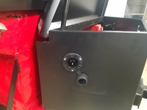

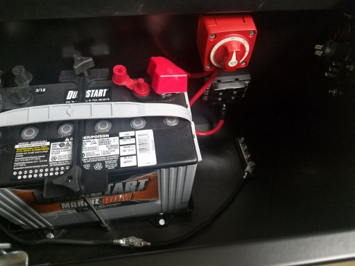

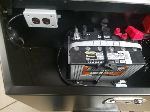

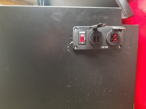

I got started on my electrical box today. After a ton of research, I found that the Durastart marine agm is the same battery as the Duracell rv agm, but $65 cheaper. Both are made by East Penn, who also make Mid-states. AE6A0ADA-DD32-4746-8F95-B83B4F2374E7.jpeg
My parts from Powerwerx showed up today, so I got busy installing.
I had one screw up I will take care of later.
More to come!

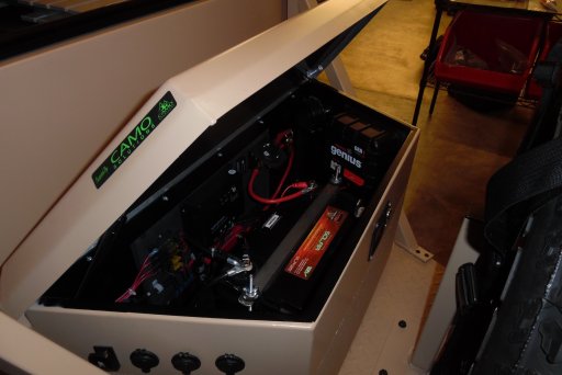

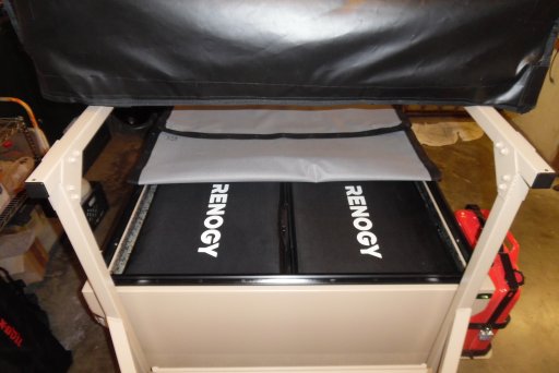

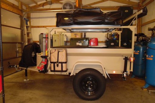

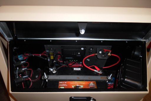

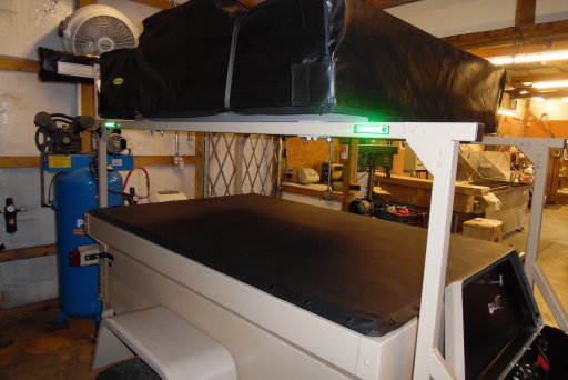

I wouldn't change any thing to my set up. My electrical is set up for solar\off grid only, I didn't want any source of shore line connections. My electrical system consist of a Harbor Freight 2 3\4 cu, ft. steel tongue box, battery is V Max Tank 125ah AGM, Charge Controller is Renogy Wanderer 30amp w\battery temperature sensor, the Battery Shut Off Switch make its so I can shut down the entire electrical system for storage while trickle charging the battery, 4 bank fuse block, 3 12volt waterproof marine grade outlet sockets on the right side of the tongue box, waterproof rocker style switch to power the 2 filtered green LED lights on the tent rack on the right side. The left side of the tongue box is the solar port for the 2 100 watt Renogy portable suit case panels to connect into. This port runs 20ft. awg cable for the solar panels. What is nice about my solar system & the way I designed it, is I can connect both 100 watt panels together in "parallel" to receive 60 amp-hours per day or just hook up one single 100watt panel for 30 amp-hours per day depending on how much 12volt gear I want to use & still maintain charging my battery properly. The on board charger is a NOCO Gen 1 single Bank 10 amp On-Board Battery Charger. Digital Battery meter w\auto shut off. It's a simple electrical system I came up with but very safe & reliable.
I wanted a 100% off grid solar system that gives me the amount of power to supply my 12volt gear during different times of the season camping & still have more than enough reserve into my battery for charging.

I've camp'd in over cast \ cloudy days on trips & never had any issue of power. The panel or panels are producing power 25 % or up during cloudy days. Whether using one panel or both connected in parallel I just have to watch the power usage on those days. The solar system over-all Renogy I have zero complaints. I done lots of research on solar companies & settled with Renogy for the German built cells, their quality of the product & service is 100% outstanding. I gave them all the 12v. gear usage draw consumption data, times of usage & they came up with a fail safe system.
My battery is fully charged by the on board charger before we leave & the battery system is shut until we get to the area we plan to camp. I made the choice of a 125amp hour AGM battery because of they hold up very well in cold weather, VMax Tanks (battery I have) loose very little power during storage & have a 8 to 10 year life span. The 12v. gear we run is usually our Engel fridg\freez, Zodi Hot Shower system I converted to 12v., & Endless Breeze Fan during the hot summer nights. The Engel doesn't draw that much power, LED tent light strip is on only until we settle in bed, & the filtered LED lights on the tent rack are in use only when those late night bathroom runs are needed. As of the thought of DC to DC charger?, yes I thought seriously on this when I was doing my ground up build of my trailer when I came to the electrical stages of the build. But decided to go solar 100% & like I said never had issue of running out of power. My battery never dropped below 15%.

When I ordered my solar system from Renogy all the manufacture's data was given on my 12v. gear, as well as the Geographic's (location), time frames of use, & the time of seasons for use. I informed them with I wanted the best system that will offer the wife & I. This is what they offered: Battery size, panels: the ability to run 2 100watts or a single 100watt, 30 amp charge controller that will handle up to 400 watts of panel or panels, cables size & the length. I have no reason to change up my solar system. The key for a good reliable solar system is to supply enough power for the gear in use during peak hrs as well as charging the battery or batteries to have the reserve during non peak hrs. This is what my system does.
We camp during early fall, early spring, mid spring, early summer & mid summer only. Late fall & winter we hunt & trap here on our farm so our trailer is parked in the shop building.
