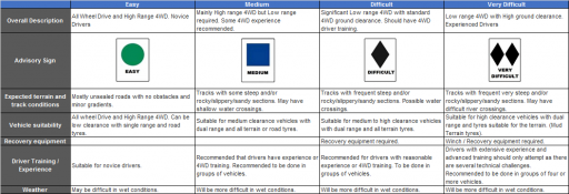

I know "do your planning", "be prepared" and "keep it simple" are all good mantra's in 4wd'ing but how can you tell from a map the degree of difficulty a track is? Also, someone's "easy" maybe someone else's extremely difficult - what do we measure this by?
Here's a track grading classification scale from Australia that has been developed to assist in advising people on 4WD trips of the type of tracks that they can expect to encounter.
Qns: Do we have a similar Trip Rating or Classification System used to determine the degree of difficulty that could be encountered on routes published by OB members?
If not, then maybe this is something worth considering?

Yes I’m thinking if OB take this up as some sort of de facto standard and with OB’s growth and international reach, especially with other national 4x4 associations, it could possibly become an international 4x4 standard and eventually make its way to a standard key on maps.... mwahaha

Thanks NotGumby and yes I think there are a few out there - point I was trying to make was should OB members should using some standard to show the difficulty.... personally I like the idea of symbols rather than numbers and that a “double black diamond” even sounds really hard
FYI here’s the rating at overlandjournal - but let’s Ken said there’s a few out there
I like this and I have a few thoughts.
Regarding "Expected Terrain and Track Conditions", should there be any differentiation between fresh and salt water? Fresh water is one thing but salt water, even if shallow, is a different hazard altogether.
I would suggest adding recovery gear to "medium". If there's sand involved, or even one steep/slippery area, you can easily get stuck.
Add "Airing Down Required/No Airing Down Required".
Add different levels of recovery gear "Basic", "Intermediate", "Advanced". This of course opens a different can of worms, making a chart with different levels of recovery gear from basic (snatch strap), to advanced (winch).
Ulysses,
This is a great idea!
Adopting a well established international standard is a great idea. Not everyone can read a TOPO map and evaluate the level of difficulty and even those whoo have vast experience don't always get it correct.
