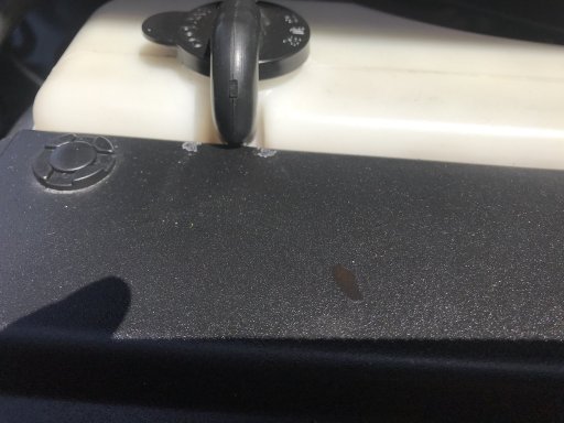

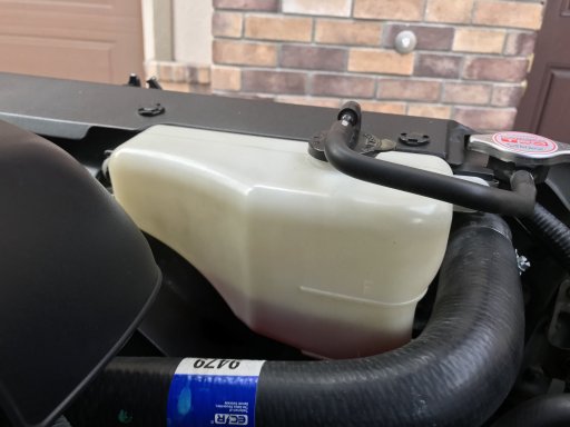

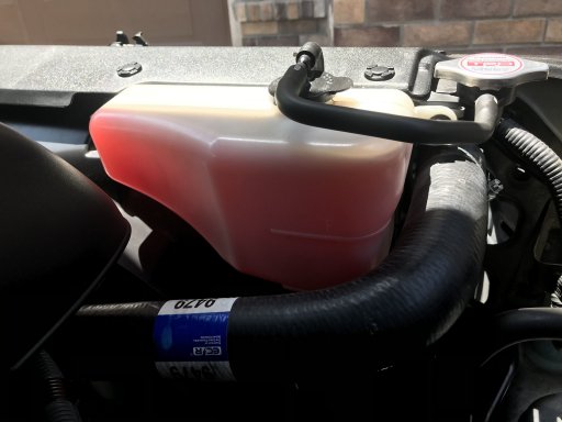

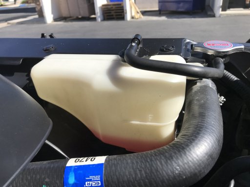

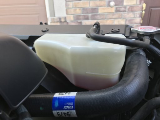

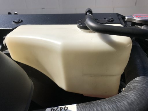

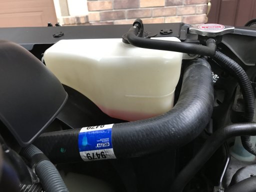

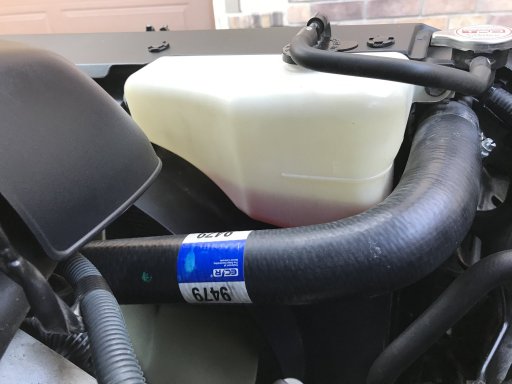

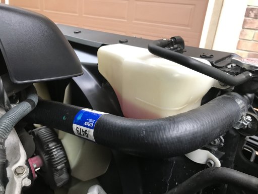

Alright... thought everything was going good, this weeks trips to work and back had no overflowing but it has been cool weather.
Today we drove to Huntington Beach and when we got there, the reservoir was full to the top but not spilling over. When we got home however, it had overflowed once again! Minor spillage but spillage none the least. Warm weather this time, no ac running the whole trip. What gives, what am I missing?? Something is wrong, I can’t go hit the trails with this problem to worry about the whole time. Any other suggestions?
Here’s the pics from today’s trip:
Before starting this morning

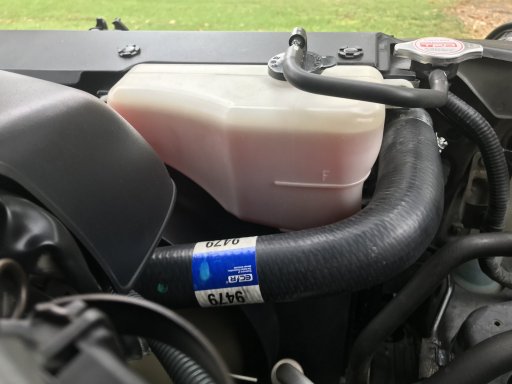

when we got to Costa Mesa

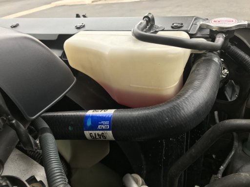

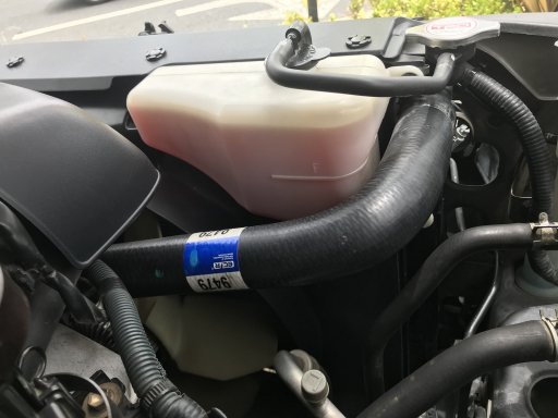

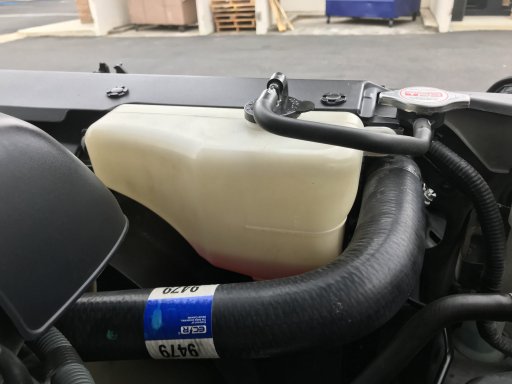

we drove from there to Huntington Beach. This is when we left Huntington

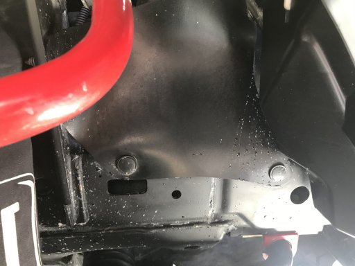

This is what we saw when we got back home

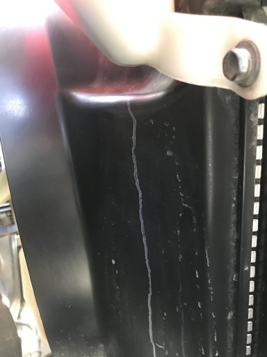

and some pics of the spillage so you can see it’s coming from the reservoir, no leaks anywhere else, no temp increase the whole drive, truck ran just fine.
This is driving me nuts!! I GREATLY appreciate any additional help on this fellas.

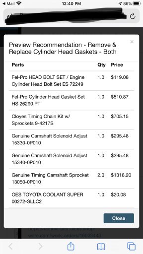

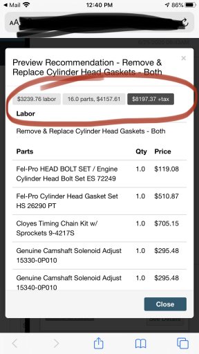

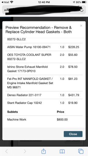

Here’s the parts list and quote from my shop. They are a great shop and have spent about 3hrs on the phone with me after hours to go through every scenario and possibility of how to approach this repair either with them or another shop even, so the relationship I have with them is very strong and I trust them completely. They have never done us wrong and have always performed impeccable service (6+ yrs). (Even with my questioning of them earlier in this thread, which I stand corrected.)
They include a 3 year warranty with this work and i trust that they will honor it fully for that 3yrs without question (which most shops only offer 1yr and the possibility they they won’t be there or honor their word in the future). I can’t lie, 3 years warranty is very tempting considering it would be hard to get that buying a used car from a dealership. Ultimately there are risks involved in any situation but a repair from this shop is as close as they come to minimizing that risk.
Look this over and let me know if there’s anything on it you see as unnecessary. I will say they up charge their parts by a long shot, I have looked up every part they listed and total came to about $2200 where they are charging over 4K. I understand they have overhead and such, but it is a bit excessive. Again, no other shop would offer that kind of warranty, that’s why I’m considering it. What are your thoughts?

Yeah, so some of this comes down to "if we're in there, why not replace it". In my experience (and again, I'm a complete stranger on the internet) it's not necessary to replace everything. It does provide a level of assurance, though.
Sidebar:: Parts markup is normal. In my experience, I can purchase parts cheaper online than our suppliers charge the shop. Online retailers cut out some middle men (which happens to be parts stores in this case). And most times, the price the shop receives is considered "wholesale" and is applied without tax. They are willing to pay that price because of the perks they get (hassle free returns and no restocking fees, free delivery, same day delivery, and supplier back warranty and even labor coverage in some cases)
Dont get too hung up on parts prices. Labor rates cover tech's wages, L&I, trainings, certifications, insurance (insurance is a bear in the shop), equipment, etc. Parts markup helps cover bills and subscriptions, service info, office and service staff, etc. And that extra cost you pay gives you a great warranty (3 years in your case; better than industry average btw) as well as the judgement and experience they bring to the job.
The list looks good. I question the need for the radiator (as you said it was replaced a few years ago), vvt solenoids and the cam gears (phasers/actuators). Sure they technically wear, but I've never had to replace any due to wear (only lack of maintenance causing carbon buildup). And the solenoids are easy to replace as they fail. Unless you have noise or codes (or if you've really skimped on maintenance) theres little functional advantage to replacing them.
Maybe ask about those and see if you're happy with the explanation.
The machine shop work seems high, but good shops charge well for their work and without an itemized list of their services, I dont feel confident speaking on the charges.
Edit: it also looks like they have coolant on there twice (totaling 3 gallons)

Why replace the radiator? It’s hold pressure, I see a whole lot of parts that aren’t 100% needed... why Fel-Pro Head gasket, intake gasket, water pump gasket, exhaust manifold gasket, when the whole set is $300.00 cheaper...
3 years warranty.... that shop (and the shops in your area) are rip offs... when we put a part on, it’s a life time warranty part and we stand behind it for the time you own the rig. The labor is outrageous...let me ring it all up tomorrow, I can’t see it booking out for 16 hours...
Reactions: Trigger T4R
800 for a set of heads is on the cheap side... just had mine done on my Bronco... it was $1600 to get them each completely rebuilt. Would have cost a little more had their been a crack. I’m still skeptical on the 16 hours.

I agree that 800 is a deal to have heads rebuilt. But I'm not convinced that's what's happening. For a simple head gasket, its really only necessary to pressure test, resurface and install steam seals (since they come with most head gasket sets). I would expect it to be in the 300 range for a pair. But as I said, without knowing what they're doing, its useless for me to assume.
Now mechanic advice can get super contentious real fast. This is inevitable, but I'd like to avoid using language that implies malfeasance. Every shop has trained techs who have lived experience and education. There are vastly different views out there depending on where that experience comes from. Everyone has their own "best practices". Mechanics get a bad rap and it's hard enough building trust with customers without other shops actively judging and badmouthing situations they are not a part of for doing things differently than they would. I know shops who would recommend some Blue Devil stop leak to seal up that small leak before it gets worse and save some money. Is that wrong? Not necessarily.
Is there an argument to be had for replacing the radiator?
-Yes, combustion gasses break down rubber and plastic (softening them) and the radiator has plastic tanks.
Would I personally replace this one due to the description you gave us?
-No. I could not justify that to the customer unless there were early signs of failure. (Again, stranger on the internet who has not inspected the radiator in question)
@Trigger T4R
It is perfectly acceptable to question their list. It does not need to be an all-or-nothing situation. If you feel that you dont want the Rad replaced, tell them. You've had the water pump tested multiple times and dont want that replaced, cool. Understand the reasoning and risk. It is your money and credit on the line, not theirs. Ask why the machine shop bill is 800. Are they doing a valve job? Guides? No shame in understanding your bill (especially one of that size).
Good shops will respect your decisions and work with you. They should understand that not everyone can justify or afford 8k on a repair.
