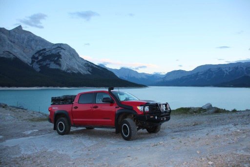

My Tacoma is my DD, and my rig. So I set it up to easily convert between the two. It takes 4 bolts and my rack and tent come off and on together. I love my Diamondback cover, someone would be hard pressed to break into it, it keeps 99% of water and dust out, and if I have a big load either I flip back just one panel, or take it off completely (in 5 mins), or load the item on top of the cover as my SE holds 500lbs. I bought KB Voodoo’s AluMax Rack which is insanely awesome and they make tonneau brackets to go around the cover and attach to the bed rails. Fits any truck, holds like 700 lbs, weighs 55lbs, and won’t rust as it’s aluminum. I added the cargo tray and was up in the Sierras last weekend at the OB Rally.
I love that it’s modular and it fits almost whatever you want to it. I have my Rotopax, hi-lift inside, Planos on the tray, and bike racks mounted. I have spare room now under the cover where my pull out drawer is, is it wrong to love your rig this much?
