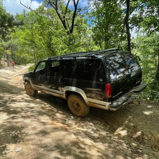

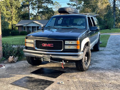

We have a stock 1997 k1500 suburban that is our primary adventure vehicle. It pulls our big trailer, hauls kayaks on the roof, and is a ton of fun overall. So far we have thrown some decent trails at it with no issues. We have not been happy with our current tire situation but don’t want to buy anything until we make a decision on lifting it.
Current setup
-265/75/16 milestar Patagonia MT (louder than we want) on 16x8 vision steel wheels
-12k winch, maxtrax, all recovery straps, shackles, etc
Thinking about
-285/75/16 general grabber AT
-2” Torsion key replacement with rear blocks
My wife is short, kids are still short (for the time being), and it’s the primary tow vehicle. I know it will gain some off-road performance with a lift, but not sure the on road sacrifice is worth it. Reaching out to the group for your thoughts, experiences, etc to help us make the decision.
