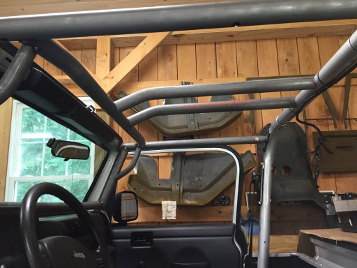

Prior to full tear down I removed the seats and built a full cage. I kept the rear hoop and used poison spiders trail kit. I also installed one of the bumpers and a couple warn winches front and rear. both winches operate from the cab as well.

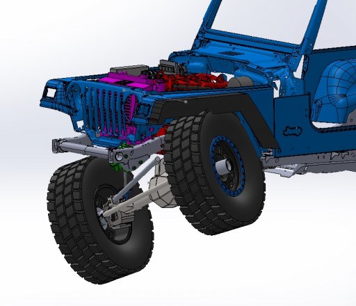

Attached are the CAD drawing of the front differential and suspension

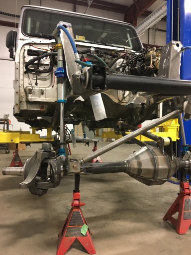

parts and more parts
Custom King Coil Shocks, Currie Fab 9 diffs with Strange / ARB differential

front differential and coilers installed and now checking compression and droop

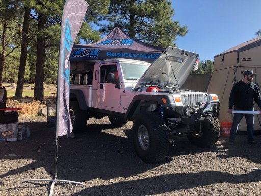

Truck as it sits today. I am changing the camping setup that was on it at EXPO to a wedge style tent and shell that is being built now specifically for the brute. Also went back to 35” tires. The R 2.8 cummins is great
If you want to see the truck it will be on display at SEMA for cummins builds
