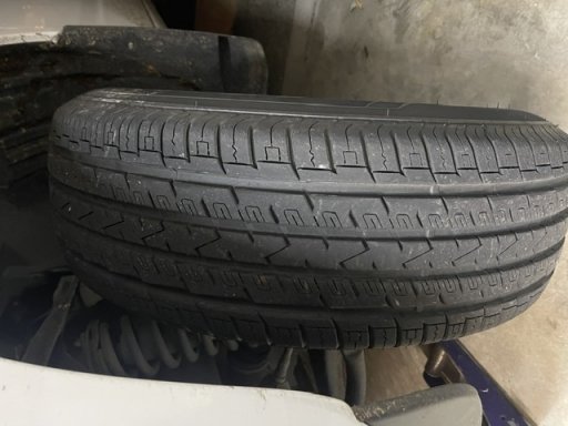

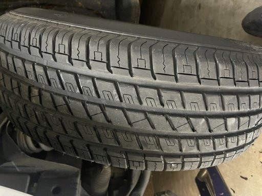

Sense I have so many things I need to get taken care of and am not ready to upgrade tires yet I busted out the ol hot tire knife and hopefully made my all seasons a little more all terrain 78FF48F4-4A72-4138-8C53-3BB194E050E1.jpeg3B19936B-09F1-40EA-B6A7-20DD274A0D25.jpeg
Reactions: MazeVX and Dougnuts
Sense I have so many things I need to get taken care of and am not ready to upgrade tires yet I busted out the ol hot tire knife and hopefully made my all seasons a little more all terrain View attachment 245230View attachment 245231
That tread pattern looks suspiciously like the Michelin Defender all season. My 2013 had a set of those when I bought it a couple of years ago. They did surprisingly well in dirt and rocks.

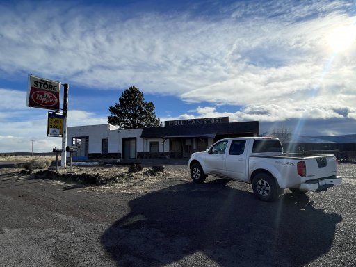

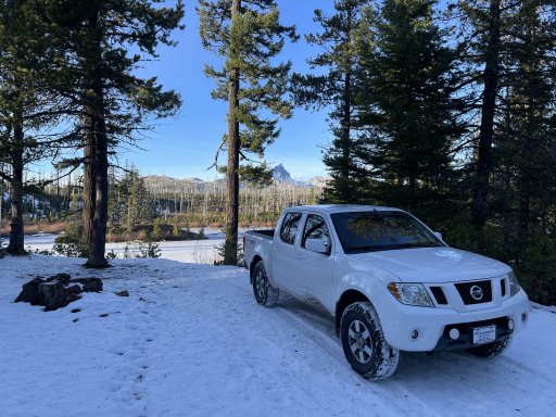

Had to do some deliveries for work in the Eugene area so decided to take the little one with me and head over to Bend afterwords . Stayed in a cool hotel with a big ol fire pit . Next day we drive around a bit and tried finding some possibly abandoned places but blocked roads kinda ruined those plans . Found some great views by an observatory and a lot of snow on mount hood on the way back . It was a nice little daddy daughter trip even though camping wasn’t involved . A suspension upgrade needs to happen in the front . With Nissans when you lift the front the struts has a tendency to contact the upper control arm and with having a spacer lift limiting uptravel the ride is a little choppy .

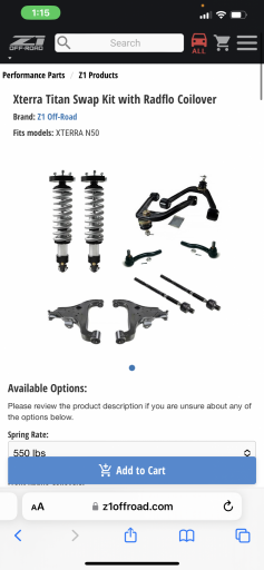

main draw for me is ride comfort , having that extra travel will really make things nicer on the trail and swapping in the Titan diff will greatly increase confidence in the front end when I’m out in the middle of nowhere solo ( I don’t ever really go out with others . From what I’ve gathered so far it’s not much more money than doing control arms and coilovers on the stock setup .
From my understanding, it's anywhere from 5-10k, if you have it done. It's probably something you can do on your own though. It's mostly a matter of having time/tools. I believe it's all bolt on anyways.

Yup, it's all bolt-on unless you're getting really crazy and going with non-stock shock hoops and things like that which would need welded in. But you'd only do that if you're basically doing a Titan swap AND a Titan long-travel at the same time, vs. just a Titan swap which is already "long travel" for an X/Fronty. I've priced it out many different ways, and I came to about ~$4k how I'd do it. For me I'd be leaving the stock X front diff, I wouldn't be looking to build a rock crawler I'd just be looking for the comfort of the extra travel (the lack of travel is really the only thing I don't love about this X). That said, I'm actually more interested in a stock-width "mid travel" setup. I'd like just a bit more travel to stay off the bumpstops on forest service roads. For my purpose this kit is interesting: Alldogs Offroad Radflo Extended Travel Suspension Lift for 2nd Gen Nissan Xterra

this is what I was thinking then just finding a Titan diff

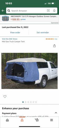

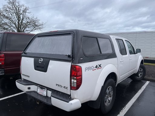

Scored and picked up a fiberglass canopy for 200$ . About 60$ worth of plexiglass and a couple hours work it has 2 new windows . Next will be insulating it a bit , making a simple sleeping platform and trying out this little canopy tent thing . Snow camping here I come 71E69C72-2A6A-47BE-ACFD-ABB0B4643757.jpegD31C1612-5ECC-4A9A-9C00-78E83FB87635.png
