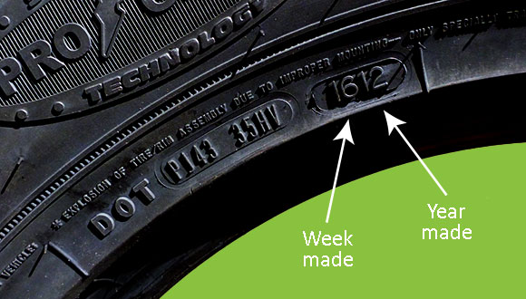

Yeah check the date. Cause older tires that have been stored incorrectly for long periods of time will get "memory" in the tire.
The tire above would of been made the 16th week in 2012. Typically you don't want a new tire more than a year old (for the common sizes), and I get new tires every 8 years regardless if they've been worn down.
