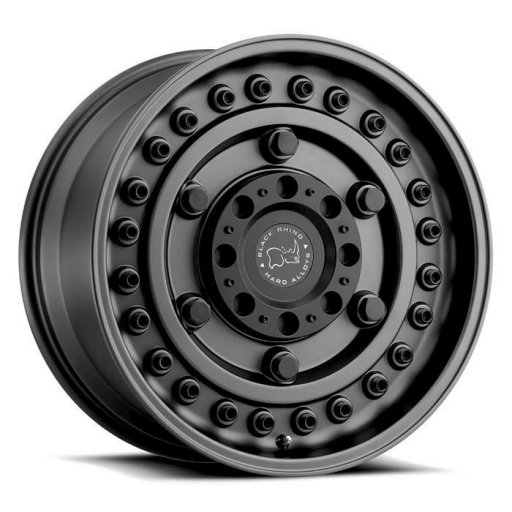

Let me know what he says. This is the wheel I am pondering....
I love those wheels appearance but I would have to question if they are a good choice on a vehicle that heavy where brake cooling is an actual thing.
I know I am just casting doubt on all of your choices here, but I hope you take it in the intended spirit.

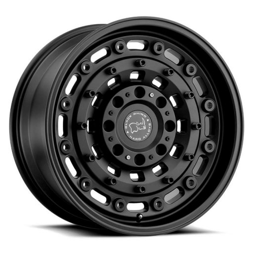

It's all good. I was actually thinking the same thing. Black Rhino has a similar wheel with some small holes that i also like...
I like both wheels, maybe the one without the holes a little more they look like military beadlocks. If you're worried about braking you can always upgrade the brake system with performance rotors, pads and calipers and really if you're looking to run 37's and pull a heavy trailer that might not be a terrible idea anyway. Once the pads wear out on my Ram I'll probably look into upgrading the brake system since I'm running a bigger 35 and most of its miles have a trailer hooked to it. If you like that style you can always go full beadlock with a custom wheel....
