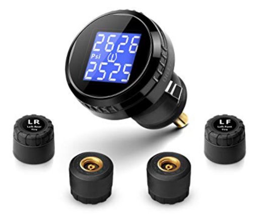

Does anybody use a non OEM tyre pressure monitoring system? There seems to be two sorts available, one that replaces the stem/valve and another that replaces the valve cap.
I’m tempted to try the second sort View attachment 80906but recently saw a video by Andrew St Pierre White describing one brand as the worse thing he had ever bought.
To be fair they seem to range widely in cost and it’s difficult to work out which the good ones are but I’d have thought the brand he tested was one of the better ones.
I’m also thinking that what might be suitable for a standard highway vehicle isn’t necessary going to work on an overland one where there is often a need to vary the pressure with the terrain.
The argument against using them offered to me is it’s another thing to go wrong and with a 4x4 tyre you usually know you’ve got an issue/puncture very quickly due to the greater sidewall height. In my case I wanted to look at monitoring pressures/temperatures to confirm I wasn’t running too high or low a pressure.
Does anyone have any recommendations?
Thanks.

Thanks for the reply. Changing pressures for off-road is one of my main concerns. It needs to be easy to adjust any high/low pressure warnings.

Haha... you are probably right. Other than catching a puncture at highway speeds there may not much between using a tpms and a good old pressure gauge but I was keen to see what others thought.
I had in mind a method called the 4 psi rule for correct tyre pressures when I was thinking about getting a tpms. Having deviated from the manufacturers recommended tyre size I was looking at ways to determine a good pressure. A tpms would allow me to monitor both pressure and temperature.
