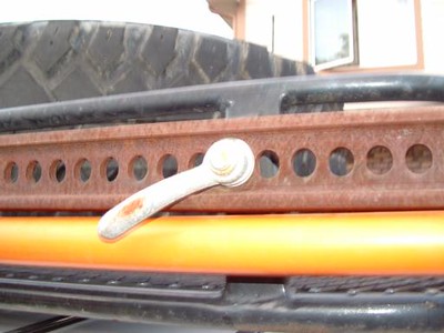

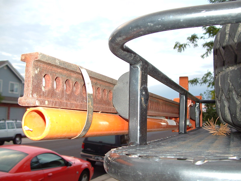

Being a fabricator and a tightwad, I built my own roof rack but wanted to hang a high lift on it. Here is what I came up with. I took a hockey puck and drilled a hole in it for a bolt, then sliced it perpendicular and made two half moon pieces. A bolt through or welded to what every you are wanting to mount to, with the puck over it and a hold down nut is all you need. A already formed nut with a handle works even better. You cinch it down and you will have a sturdy and no rattle solution.

Just remember to coat your jack with oil/grease more often that I did, or it will end up rusting. I used a radiator clamp to hold the handle up. They make some neat ones with a thumb nut so you can do it without any tools. It is also a nice spare to have in an emergency.

A couple thoughts, you touched on one - keep it lubed up! Rust is the enemy.
Are hockey pucks UV resistant? Or will they fall apart after their time in the sun and need to be replaced frequently?
How do you lock your jack to keep honest people honest?
I mounted my jack similarly to the outside of my rack until I was driving through a pretty dense wooded area and caught a thick branch and it nearly ripped my jack from my rack! After that I moved it to the inside of the rack.

Life happens. Things got tight some years ago and I sold it. I have all the materials in the shop but I really don't need it anymore.
The pucks hold up well but they are only a buck a piece. Never had anybody steal the jack but you could easily drill a hole across the end of the bolt and put a lock through it. You could also use a short cable lock like for a bike.

I have seen people hang up their rack and rip it off the vehicle with significant damage. Your point is something people should think about.
The hockey puck solution works well for many things such as Mat tracks.

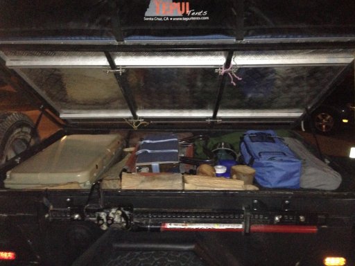

I used to have a hi lift on a rack on my jeep. Now it’s inside the bed rail under a shell on the new truck. When I had it outside I used nylon lock nuts to secure it and had the appropriate wrench in the glove box. My theory was that it’d at least slow someone down from stealing it and if I needed it, I was probably in enough of a bad spot that a few extra minutes wasn’t going to matter to me. If I lived in a city I’d probably go with the lock method. I like the hockey puck idea for mounting stuff. I was born and raised in California though and have only seen pictures of them!

I try to keep as much weight off my Jeep as possible, so I mounted mine on the side of my trailer, but that requires you to have a trailer. Originally it was mounted on the rear stock bumper of my Jeep using the Hi-Lift mounting kit until I replaced the bumper with a swingout tire carrier. I utilized the same mounting kit on the trailer.
