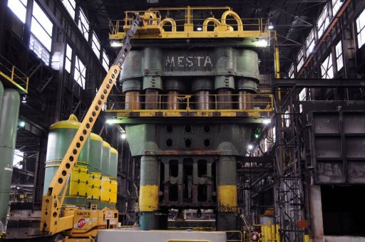

The picture below show how Dodge/Ram presses in their ball joints.....ask me how I know. LOL
