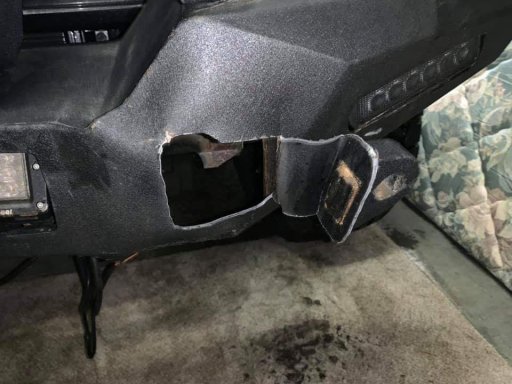

I found the best choice was the manufactures winch mounting plate. If you are confused with which winch to buy? The level of quality or lack there of in bumpers is astronomical.
Definitely buy a brand name bumper.
Also, a bulky cool looking bumper will either be heavy or heavy and poorly built. On winch bumpers, I always say look for a minimalistic bumper, winch mount. And look for higher grades of steel. When in doubt look for brand name.
